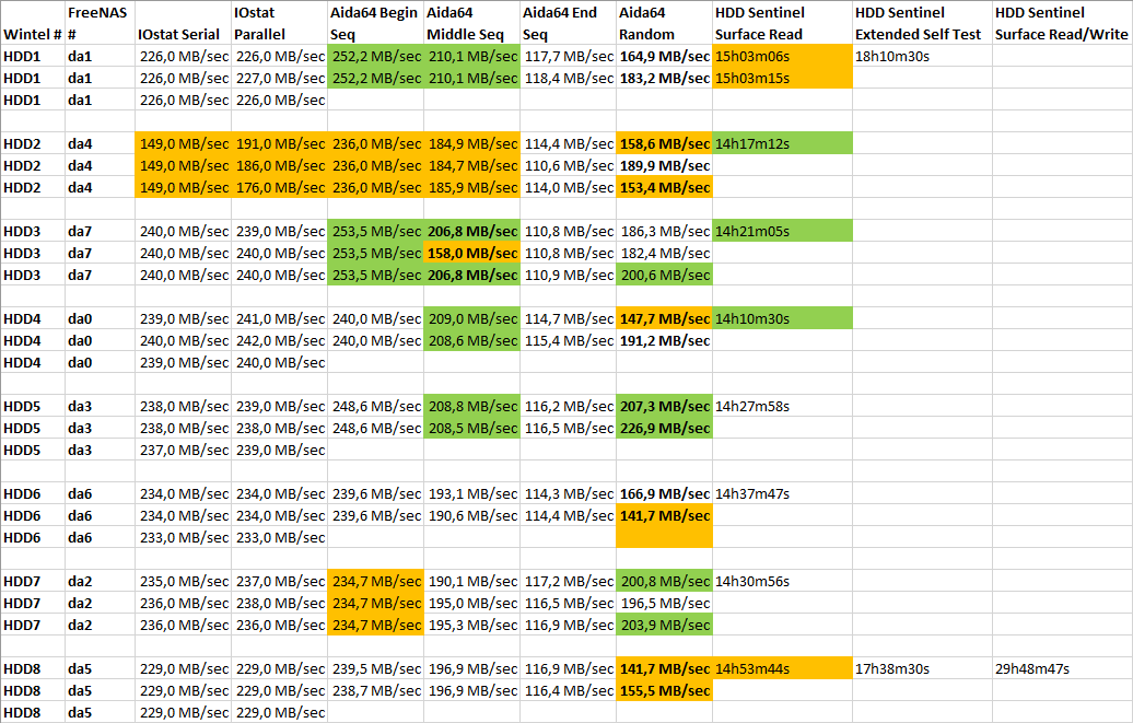

edit:
Here is an overview of all the speed tests I've done so far...
da4 seems to be a lot slower in FreeNAS (according to the solnet-array-test script), a little slower in Aida64, but strangly enough, it was faster when doing a HDD Sentinel Surface Read Test??
Should I consider this as normal variance between the HDDs and ignore this difference? The difference according to solnet-array-test does seem huge to me...

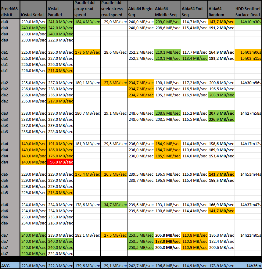

Here is a summary of my findings
1) The grep for disk size doesn't work on all my disks
Just in case you didn't read it yet with all my blabla and edits ;)
bugfix = replace the existing "disksize=" line with the below line
disksize=`(dmesg; cat /var/run/dmesg.boot) | egrep "byte sectors" | egrep "^${1}: [0-9]*MB| ${1}: [0-9]*MB" | head -1 | sed "s/^.*${1}/${1}/" | sed -n 's/^[a-z0-9]*: \([0-9]*\)MB .*$/\1/p'`
2) Disk speed variances that worried me
I've tried to gather all my "speedtests" so far in the below table
da0 seems the strongest. da4 and da5 seem the weakest.
Although da4 consistently scores exceptionally low in the IOstat test, it scores very average in the dd test (and all other tests except perhaps Aida Middle Seq). I'm still not sure what is causing these bad IOstat scores, but as it is scoring average in most other places, I'm hoping it might be ok. Could it perhaps be because I have an active FreeNAS filesystem on all disks (it was 100% unused during the test, but still, maybe something like a patrol-read-equivalent or other maintenance job could cause this?). Maybe I'll retry it once more after destroying the pool/zfs...
da5 scores the weakest in the dd tests and also in Aida random, but not alarmingly low...
edit: doing 1 more final run with the zpool destroyed and FreeNAS rebooted...
So far:
IOstat serial=146MB/sec (still ridiculously slow)
IOstat parallel=241MB/sec (from very slow to very fast)
So although it partly helped, there is still something weird going on with da4
Mastakilla
Jul 18, 2019
203
As I suspected my HBA from running too hot and causing these issues, I've replaced it and added a fan on it. This has slightly helped with the above inconsistencies, but not as much as I've hoped...
Results can be found in this thread
