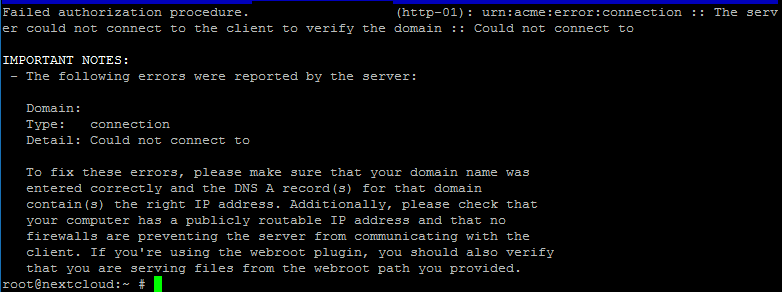

Hi again!
I had to set everything up new. So i had to follow your guide anew. Now I am facing the problem (which was no problem before), that when I want to retrieve the certificate from certbot it cannot connect to my IP (http-01). Here´s a screenshot of it:
That is usually a connectivity problem. From my understanding you need a Fully Qualified Domain Name pointed to a valid DNS for certbot to work. Mine wouldn't work until my domain fully propagated. Google DNS propagation checker and type in your domain, if it's all green then I'm afraid someone else or Google will have to help you. Certbot does NOT work with raw IP addresses (at least when I tried)
I know that, thank you. It worked with my previous install (same IP, same domain, same setup). Hmmm. Thanks for your work and thoughts.
