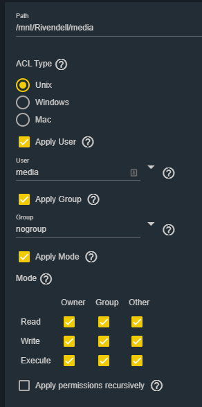

Why do you say /media is owned by root? It is owned by "media" as noted here.
