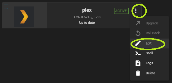

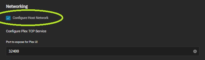

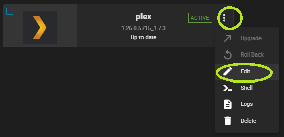

grapes17
Jul 12, 2022
I was able to resolve my issues by editing the active Plex application and checking the box for "Configure Host Network". I believe I had opted to leave it unchecked after watching various setup videos and not seeing anyone check it (My Mistake).
Steps:
Thank you @truecharts & @winnielinnie for fielding my questions!
Thank you thank you thank you!
I had this exact same issue, and it's been bugging me all week. I finally did a search, landed here, and your answer is the one that solved my issue.

The_Giefster
Dec 11, 2022
Steps:
This was my issue as well. If you do not have "Configure Host Network" checked then plex listens on its Kubernetes IP rather than your local network IP.
