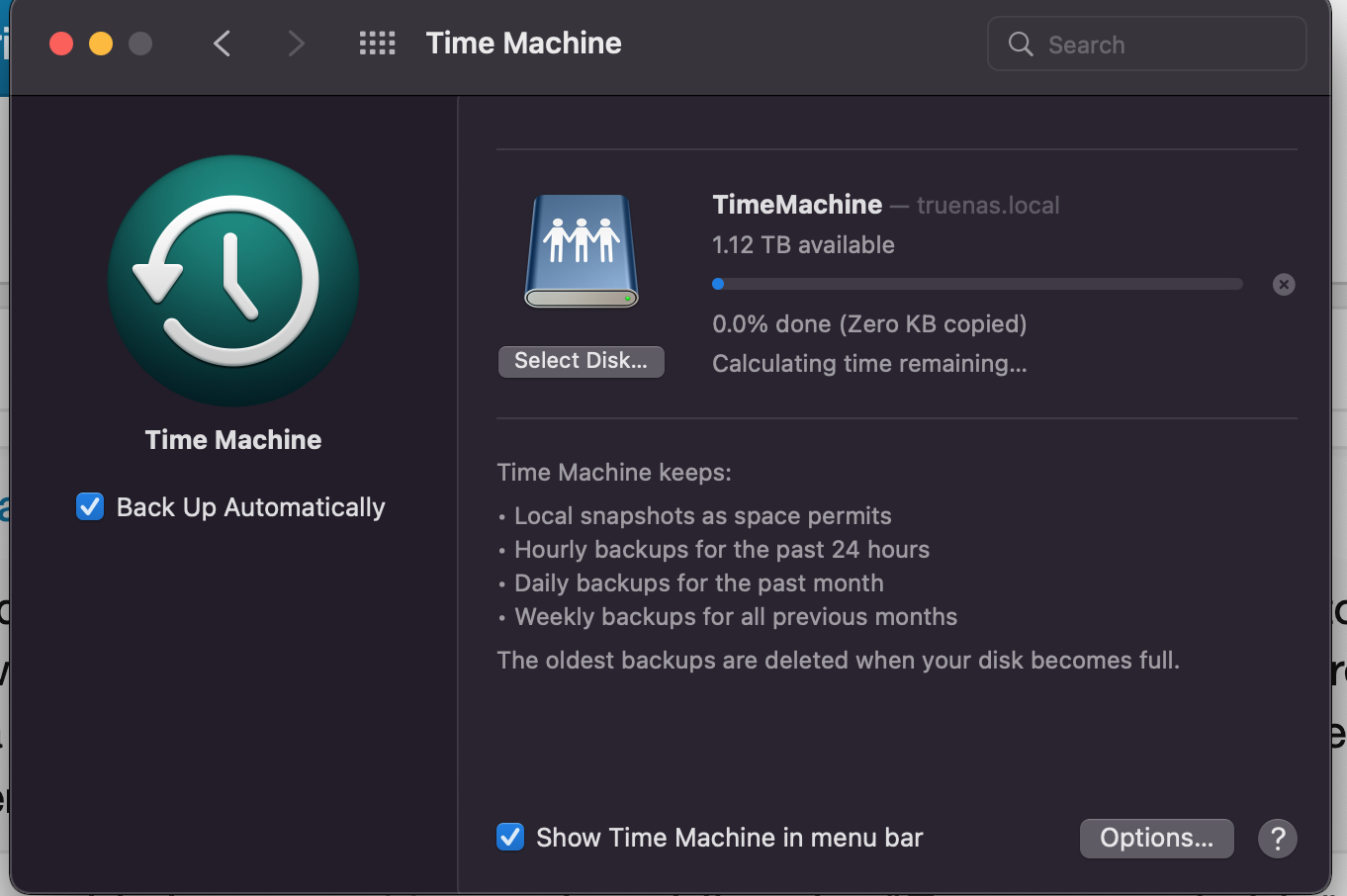

dabrahams
Jan 1, 2022
12
This is so weird! For what it's worth, this worked for me without enabling "export recycle bin":
  1. Enable "Guest Access" in Sharing > SMB > Edit > Advanced Options.
  2. Begin a time machine backup from any Mac to the share.
  3. Once a little data has been copied, stop the backup, (optionally) delete the created sparse bundle
  4. Disable "Guest Access."
  5. Set up as many macs/users as you like connecting to the share. Everything just works.
Since everything is working for me now with "Export recycle bin" off as well, I wonder if @Das_Schaf or @GBaughma are able to turn that option off now with no ill effects?
