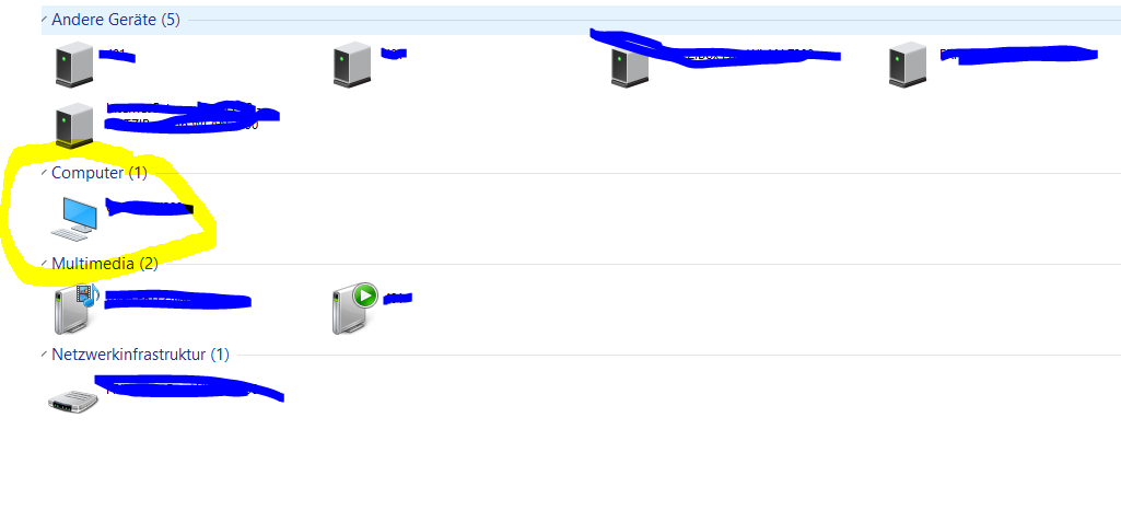

Hey, sorry for opening this old post.
But I try all the settings in this posting, and can't see my Freenas (11.2 U5) in the Windows Network Folder.
I run also a QNAP NAS, and I can see these in the Windows Network Folder.

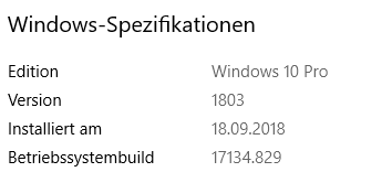

@airduster What version of Windows are you using, and are you on an Insider build?
  • Can you access your shares by manually navigating to them or adding them as a network share/mapped drive?
    • i.e. Windows Explorer -> \\FreeNAS\ShareName

Hi, I can access all shares via \\Freenas\ShareName.
I have also some shares mounted as network drive.
I can also see other PCs in my Network in the network browser.

@airduster If you've tried all the solutions offered in this thread, I'm not sure how to troubleshoot. I personally don't use Network in Explorer, but I can offer a few roundabout solutions:
  • If you type the FreeNAS hostname into Explorer, it will show all shares available (i.e. Windows Explorer -> \\FreeNAS
  • You can add your FreeNAS hostname as a folder in the navigation pane of Windows Explorer by merging the following into the Registry.
    • However, due to Windows 10 disabling automatic registry backups, first merge the following into the registry, re-enabling auto registry backups, reboot, then perform the merge of the Nav Pane.
      (This ensures should anything go wrong, there's an auto backup... you can also manually backup the registry via RegEdit.exe)
