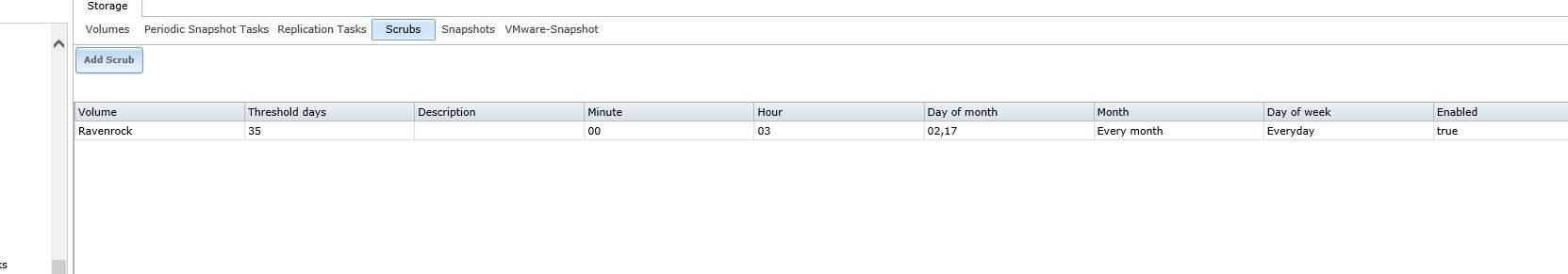

So ive been running myfreeNAS rig for a few months now and I don't know if a scrub or Smart Test have ever run. I thought it would email me the results or to let me know it completed but nothing. I do get the emails for my temp alerts, updates etc though. Is there a way to check to make sure they have completed? A history or something?
Also attached below is my schedule for the Scrub. Have I set it up correctly? I believe I set it up to run at 3:00AM every 2nd and 17th of the months with a threshold of 35 days. I assume threshold means if a scrub hasn't been in 35 days it will do one right?
Thanks!

Scrub schedule looks good.
Right, which could be considered rather a long interval. You might consider reducing it to below 15 days to allow it to run on your set schedule. I have my interval set to 1 day and a bi-monthly schedule
