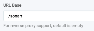

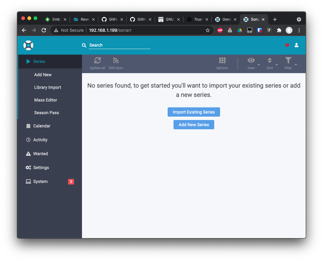

OK, I've now been able to confirm this is not required (VMs are awfully handy for testing)--here's my Caddyfile:
:80 {
    root * /usr/local/www/html
    file_server
    reverse_proxy /sonarr* 192.168.1.121:8989
(The TrueNAS IP is 192.168.1.121; Sonarr installed using the plugin with NAT), and here's Sonarr through the Caddy reverse proxy:
...and here's the setting in Sonarr you were missing in order to make it work:
(it's under Settings -> General). The other applications should have a similar setting.

Okay, I changed that setting in Sonarr that you posted but there must be something wrong with my setup, somehow.
TrueNAS IP: 192.168.0.200
Caddy IP: 192.168.0.199
http://192.168.0.200:8989 | Loads Sonarr Web UI (But now redirects to http://192.168.0.200:8989/sonarr)
http://192.168.0.200:8989/sonarr | Loads Sonarr Web UI (Works as it should - default setup)
http://192.168.0.200/sonarr | Redirects to TrueNAS Web UI
http://192.168.0.199/sonarr | Blank white page
http://192.168.0.199:2020/ | "Hello, world!"
http://192.168.0.199/test.txt | Blank white page (Should download a .txt file or show it's conents)
