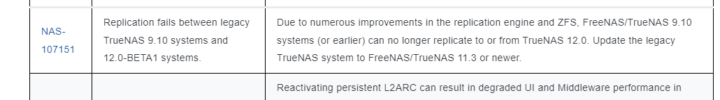

I was wondering if anyone could help with a replication issue. I'm trying to transfer all the files from one PC running FreeNAS 9.10 to another PC running TrueNAS 13.0.
On FreeNAS 9.10, I completed a Snapshot, and is visible under snapshots. When I try and do a Pull replication from TrueNAS, it seems like I don't see the snapshot. On the TrueNAS machine, I get the error below where Utopia is the storage pool name. Am I missing anything that is prevenging the replication? Thanks for your help.
Error on TrueNAS
[zettarepl.replication.run] For task 'task_1' non-recoverable replication error ReplicationError("Dataset 'Utopia/manual-20231023-clone' does not have any matching snapshots to replicate")

I suspect this may be (related to) your issue, copy from the 12-Release notes:
