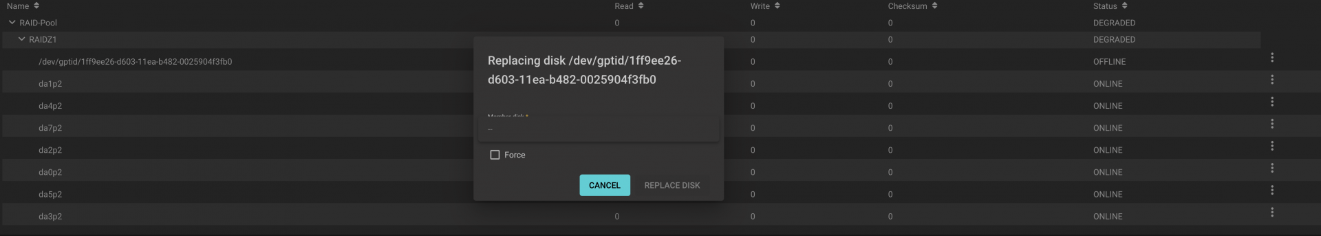

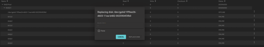

Hello, I am trying to replace hard drives with larger drives. I have been able to successfully replace 2 drives but on my 3rd drive, there is no disk choice, I only see "-" when selecting replace. The steps I am taking are
- Setting the disk I'm looking to replace as offline
- Hot swapping the disk with the replacement disk
- Clicking on the new disk and selecting replace and selecting the disk (At this step I'm only seeing "-" instead of da6)
- Allow disks to resilver
Am I missing a step or what can I do in order to resolve this?
I am attaching a screenshot of what I am seeing.
Thanks in advance!

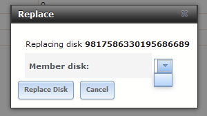

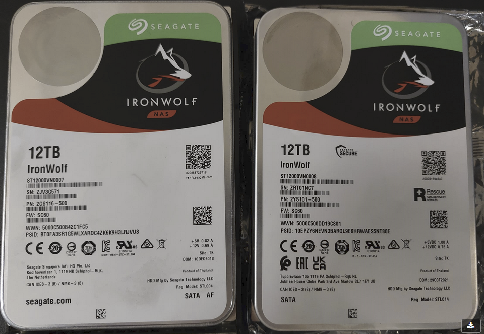

the disk on the left is the first disk that failed, the right is the new one
am i missing something?
do you need any further information?
thank you very much

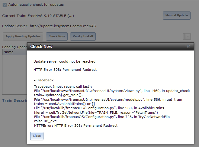

i'm still trying to solve this problem. I already saved some of the most important files, but not all. Right now i'm trying to Update FreeNAS but also get stuck. As mentioned i'm running version FreeNAS 9.10 and when i try to auto update i get this message:
a ping to google for example or a nslookup works fine, also a curl.
when i enter the webpage via browser and try a manual update with for example "FreeNASUI-11.0-RELEASE-64bdd482f3f4159771030dd9776721db.tgz" i get the following message after step "1/3 Uploading Update":
any ideas?
best regards
Chris
Well, clearly the updater was setup to not accept redirects - and I'm not sure it would know how to deal with what's on the other side anyway, all these years later.
You can just update from install media and import the config database (be sure you have backed it up before you do anything, in any case). Expect to have to reconfigure permissions for SMB shares.
