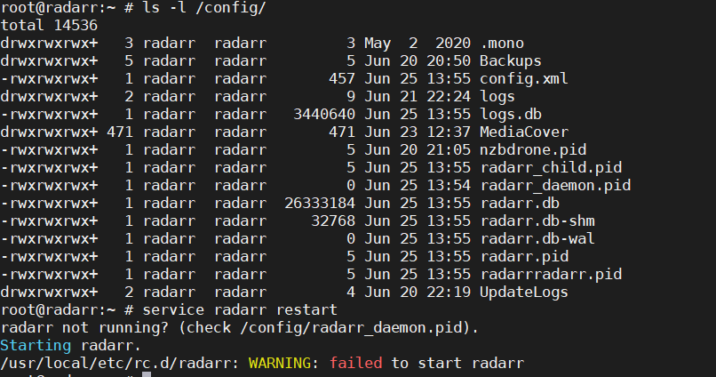

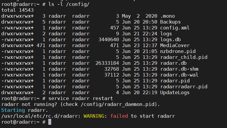

as for why it fails to start try running it outside of the service `/usr/local/share/radarrv3/Radarr` (and preferably as the user you currently run radarr as)
the typical failure start is caused by incorrect permissions on the pid files as mentioned above so definitely check that too.
I have the daemon rip out both stdout and stderr so anything that is failing before the logging inside radarr occurs will not be seen.
Jan 27, 2020
577
please use `sysrc` to change variables setup in the rc file instead of editing it :(
Yes, of course. I did that.
Everything seems to have the right permissions.
9,700
Except for the file that isn't there... radarr_daemon.pid
You might want to create it with touch /config/radarr_daemon.pid and make sure it's owned as expected.
Nope.
