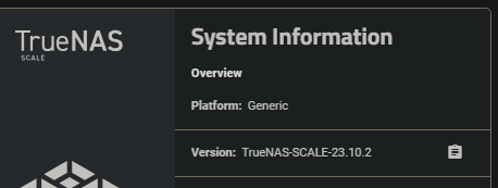

Worked perfectly on 23.10.1.
But after upgrading to 23.10.2, Onedrive was unavailable again.
After following your instructions, middlewared service does not start anymore. also after reboot.
Managed to revert back to 23.10.1...
