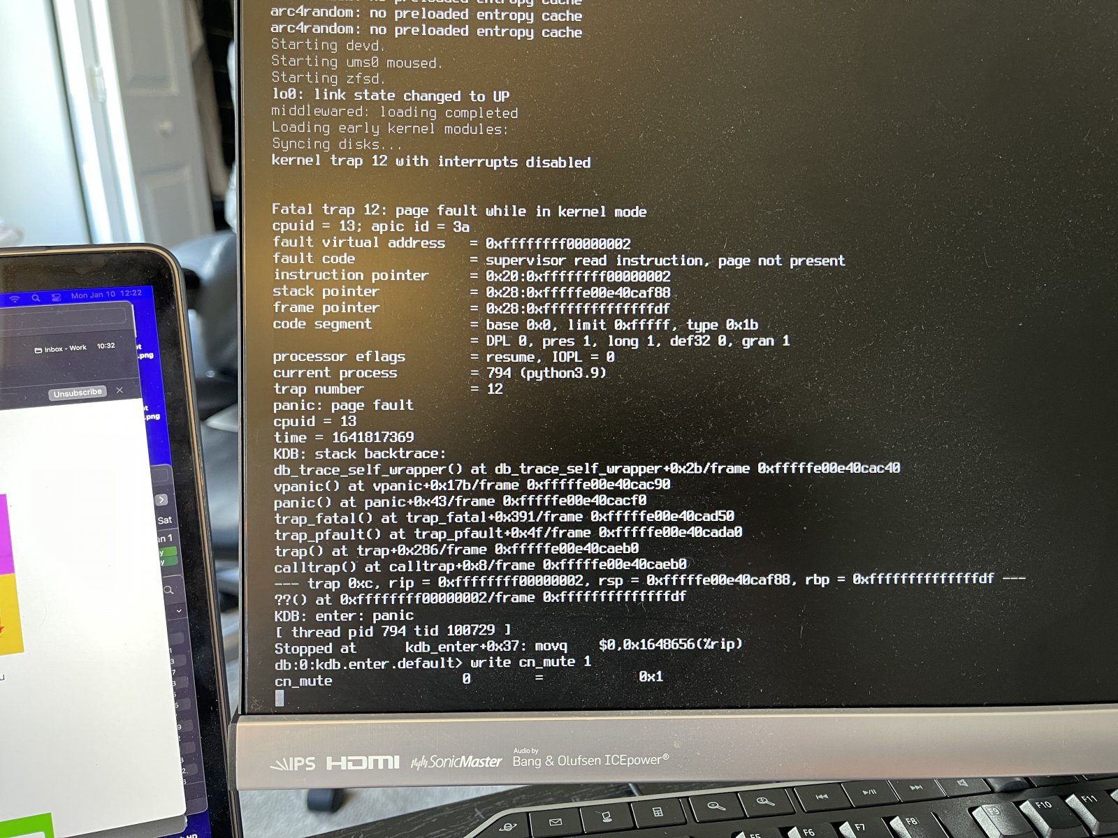

I just finished my install and now on first boot I'm in a panic loop. Hardware as follows:
  • ASUS Prime Z690M-Plus D4
  • Intel i5-12600K
  • Corsair Vengeance LPX 16GB (2x8GB) DDR4 DRAM 3200MHz
  • Samsung 970 EVO Plus Series - 250GB PCIe NVMe - M.2
  • 10Gtek Internal PCI Express SAS/SATA HBA RAID Controller Card, SAS2008 Chip, 8-Port 6Gb/s, Same as SAS 9211-8I
  • 2 x Seagate - BarraCuda 8TB Internal SATA Hard Drive for Desktops
I've installed TrueNas 12.0-U7 on the SSD and it boots to the load screen but crashes/hangs at different times. Sometimes the middleware load hangs it up, sometimes it panics after syncing disks (page fault while running PID 794, which is a python process), sometimes hangs after Alarm clock. It once came all the way up to the menu where I could configure everything, but I rebooted to see if was a fluke (and it was; it panicked again). Troubleshooting steps:
  1. Reseated RAM
  2. Ran memtest (one pass showed no errors...was going to run it longer)
  3. Removed HBA (no drives on it yet)
  4. Disconnected SATA drives
  5. Changed ASUS MultiCore Enhancement from "Auto - Lets BIOS Optimize" to "Disabled - Enforce All limits"
  6. Disabled HD Audio, Bluetooth/Wifi, and Aura
Based on how the system is behaving (crashing at different times), I'm thinking this might be a clocking issue? Is there anything else in the ASUS BIOS I need to tweak? This feels like I'm missing one silly thing.
Any thoughts/suggestions?

Given what you already did (I assume all at the same time, also assuming that all parts' specs are known compatible) I'd first take the board out of the case and fire it up on the antistatic packing with just the processor and one stick of RAM to eliminate the question of shorts to ground. Then work up from that point.

I reset the BIOS back to defaults and booted into Safe Mode with Verbose. As it scrolled by I noticed one of the lines indicated "pic: unknown intel cpu"; not sure if it was relevant.
Anyways, the system booted fine and I now have a GUI. Would anyone be able to explain the difference between Safe Mode and Normal Boot? And I guess, more importantly, why the system booted for me?
SteveKB
Dec 30, 2021
17
As mentioned in another thread, the issue was with Alder Lake Efficient Cores. Turn them off and everything works fine (except you have cores turned off :confused:)
