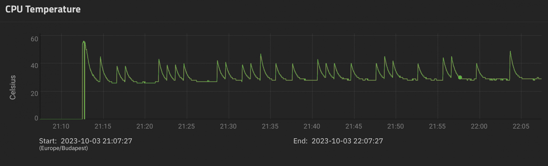

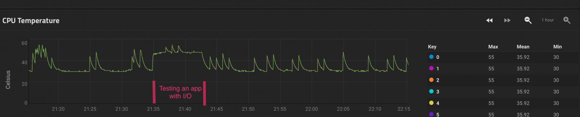

Alright, the results are out. :)
TLDR: I think that there is a major improvement. I still see spikes, but they are usually (not always) every 5 mins instead of the previous 1 min interval. This much may be fine (I will try to investigate further).
I tried playing around with the settings etc. What I found were:
- With a fresh install, re-creating the Pools and Datasets etc. instead of importing them, the spikes still happen, but roughly every 5 mins. Although I am not sure, I would guess that this should be when the system dataset gets written into. No writes in-between.

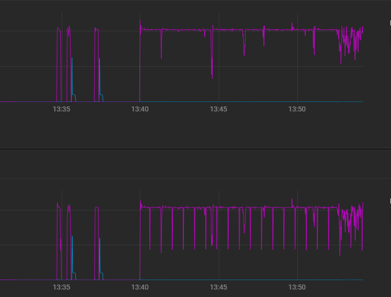

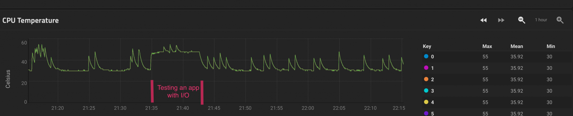

- After adding an app, setting up shares etc., things aren't looking as good (the app was stopped after installation to mitigate any I/O etc.). This is because at this point, the CPU spikes started happening more often. Still not as often as previously with BETA-1, but still plenty of spikes. (The red interval is when I started an I/O intensive app, which was then stopped.)

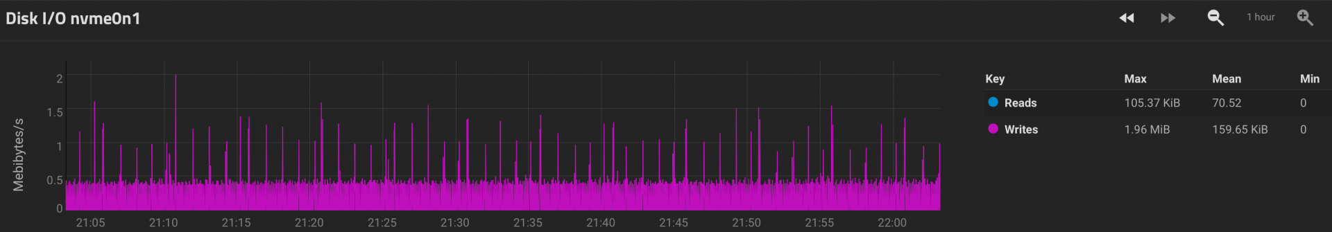

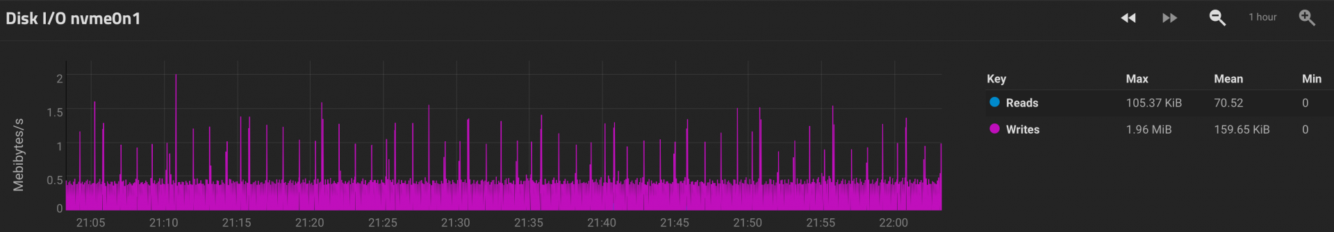

- It was mentioned in the ticket that the logging has somewhat changed. I think I can verify this, as it seems that every value is being logged a lot more frequently: the values of the dashboard are being updated much, much faster than they were on Bluefin (at least for me), and also (as a kind of drawback I might say) the disk I/O looks weird on just about any disk if there is any I/O as the logs are just too frequent (see the image below).
- Due to these "too" frequent logged values, it may be that at this point, this much is fine. I will try to measure how much power the system is using with a meter I have at home. If these bumps are in any way important, then I should be able to see them on the readings. If there are no jumps in the readings however, that would mean that this is fine now and this is now only because of the updated, too granular logging frequency.

I would say yes. The spiking is now a lot better and more bearable than it was on BETA. However, in my opinion at least, it is still too frequent and does not seem justified on a system with freshly created and almost entirely empty pools and datasets. I thought that the spikes were only happening roughly 5 minutes, which, as you noted, could be regarded as a perfectly normal phenomenon. However, after a bit more testing that I did this week, the situation seems to be a bit more nuanced, as the spikes are not limited to every 5 minutes.
Since this was my first NAS, I had a power meter attached to the NAS from day 1 on Bluefin, so I have an idea of how much power it uses when not in use (e.g. when I am not transferring any data etc.). The PC would sit at about 51.5 to 52.0 W mostly, with some slight jumps up to 54W at most. I tested the same setup now on Cobia RC, and what I found was that the power usage also spikes when the CPU temp./usage graphs spike, meaning that the logged spikes are not simply a result of the changed log frequency between Bluefin and COBIA.
The base wattage is still at around 52W, however, when the spikes happen, the power usage jumps all the way up to 70W, regularly. Also, sadly this happens way more often than 5 minutes. From my experience, it happens a bit randomly, sometimes every 1 to 1.5 minutes, and sometimes 2 or 3. Some other times, it goes on for 5+ minutes without any spikes (see the attached image, where the spikes are happening way more often than 5 minutes).
I think I will have a look around, as I have some vague memories that this started intensifying after moving the system dataset to an SSD.

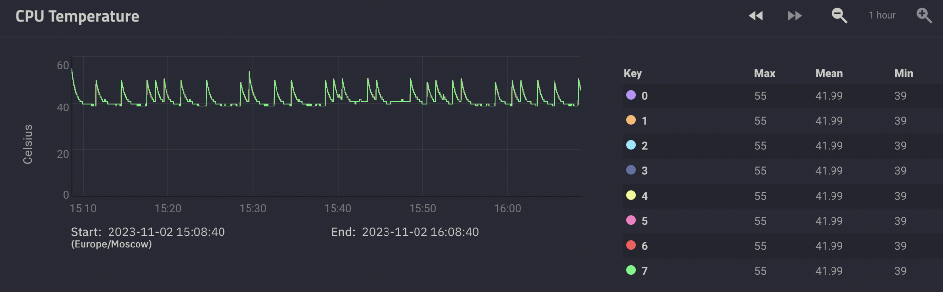

Nov 2, 2023

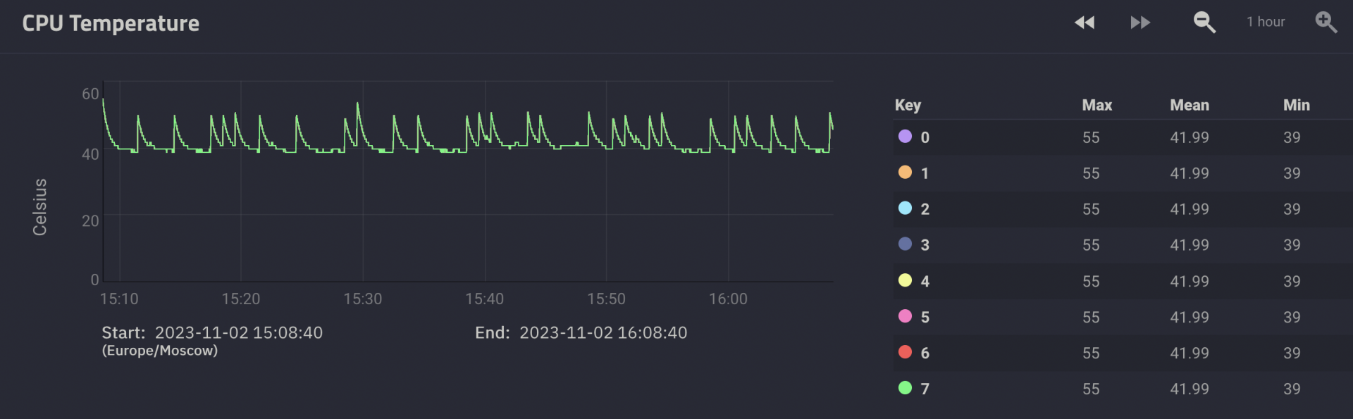

I have the same problem as @fornex after updating from Bluefin to Cobia - high CPU usage spikes every 2 minutes or so. This is weird, since on Bluefin CPU usage/temp graph line was flat when system is idle. Is there any way to find out what is happening during this process is running?

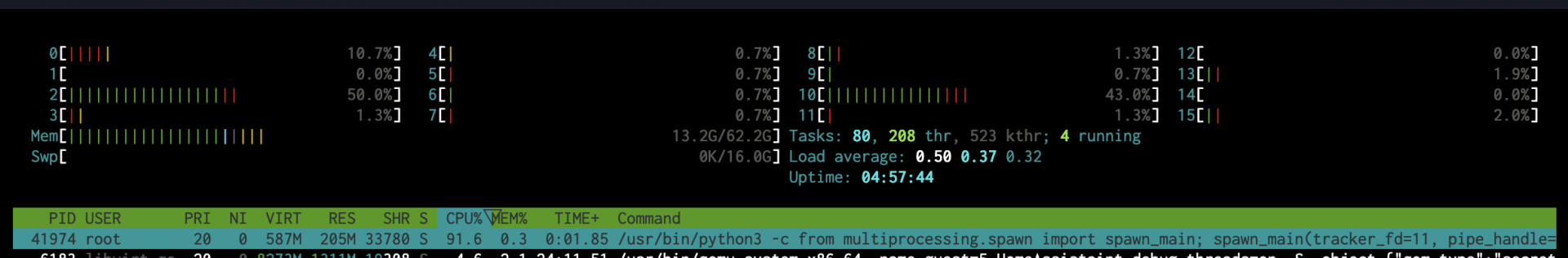

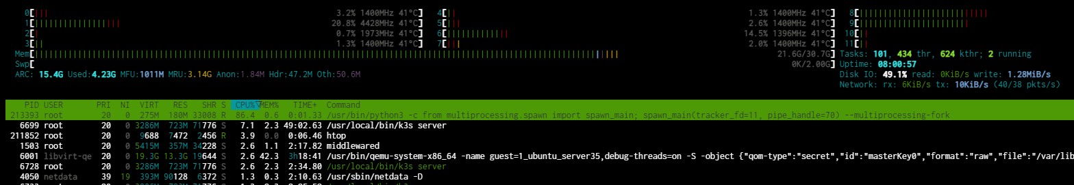

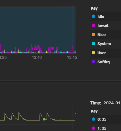

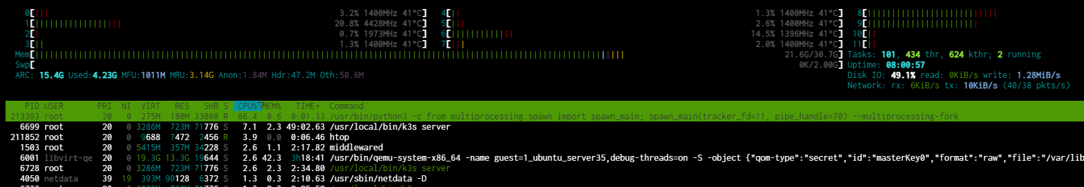

Phas2
Nov 11, 2022

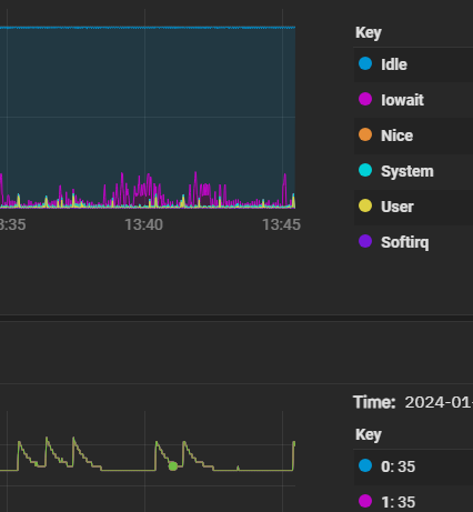

I would like to report this same behaviour as undesired. It also started happening after the upgrade from Bluefin to Cobia.

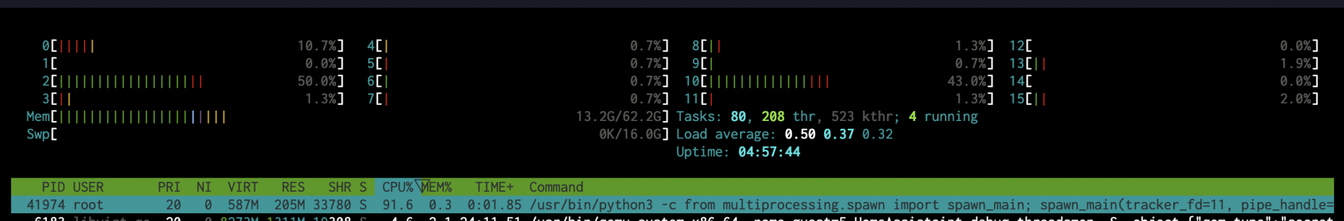

after some time looking at htop I managed to capture the process name but also noticed sometimes it would appear up to 3 times.
Perhaps it is so impactful to the system because it runs as a "user" task and gains some kind of priority causing the cpu to raise core speeds.
I'm running on a AMD Ryzen 7 PRO 4750G with Radeon Graphics.

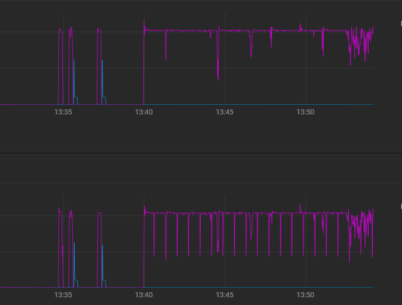

On this truenas server I also use a VM for running a game server and every time this check happens there is a noticeable interruption to tick times leading to a bad experience playing the game. Before Cobia it was much more stable. To show this kind of interruption I ran an openspeedtest from the VM connecting outside my network. Above is the virtual adapter for the VM and below is a 10gb network card.
