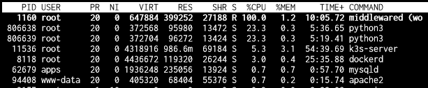

'middlewared' process spikes CPU usage in one minute invtervals
Apr 8, 2021
7
I noticed the CPU fan was repeatedly spinning up. Looks like the 'middlewared' process (no idea what '(wo' stands for) is using a lot of CPU capacity, every minute, for a few seconds.
Is this normal behavior or a known problem? I didn't find any reports which matched this behavior.
I'm on TrueNAS-SCALE-22.12.3.3

WO is cut off, it's actually middlewared (worker). Middlewared is truenas process, What CPU do you have?
