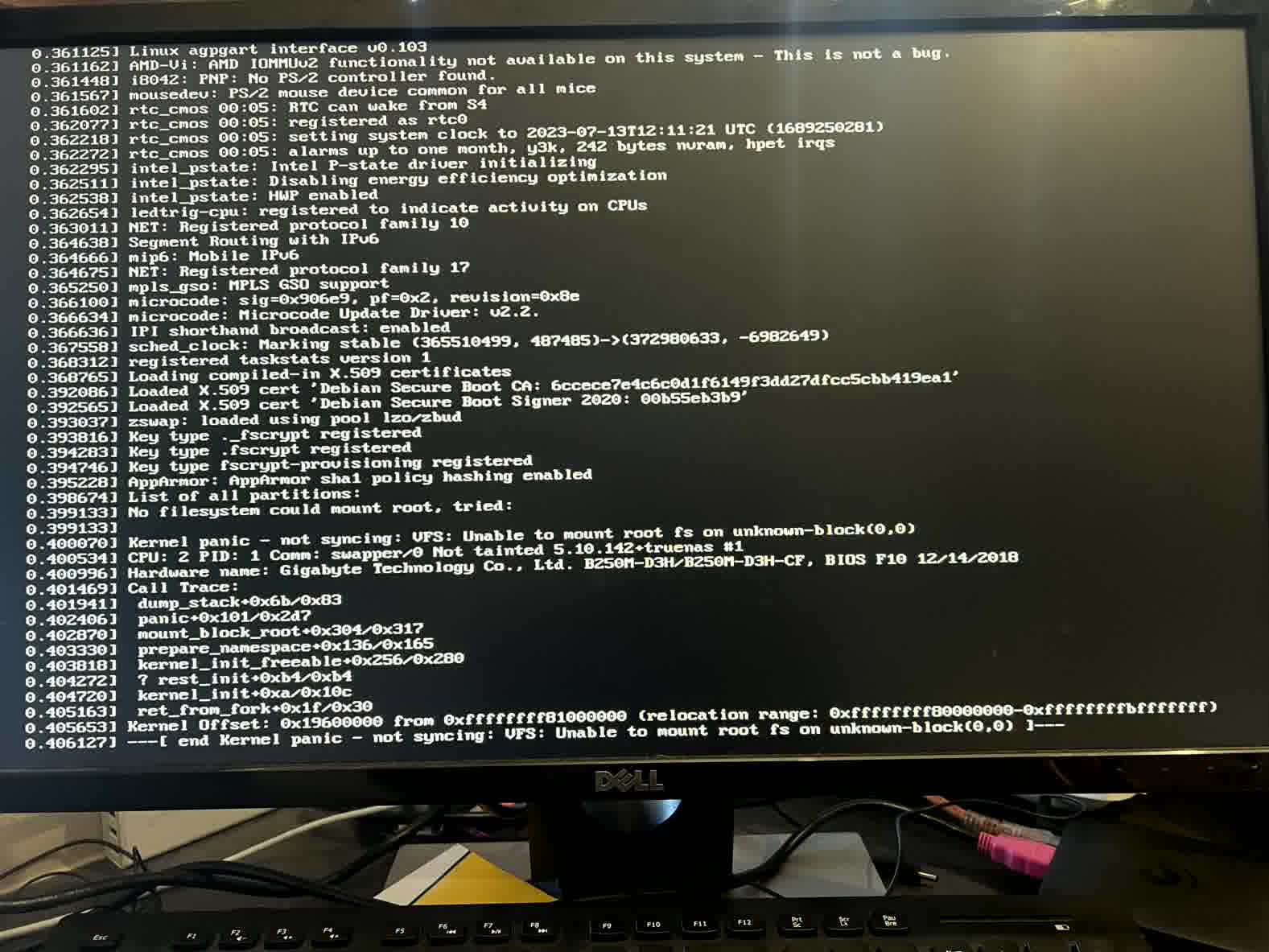

Houston, we have a problem.
Kernel panic, see attached.
Whats my next step, this is where I get scared...
G
G
9,700
Seems to be issues with the boot media... do you have another option to try?
Otherwise, you should still be able to boot back to the old boot environment.

booting back into core, in the mean time, or make wanted to... same error on CORE re the kernel panic.
get the idea that USB drive have now gone...
please advise.
i also thought so... but seems problem is that USB now.
how do i build a new install, download iso to usb, insert, from from it and then install to target drive..
will it see my old storage i have a config file, but it came now from my core setup,
can i do all of this with scale, or do i have to first rebuild with core

9,700
Probably... welcome to the 99%
Hopefully you have your config somewhere and it's just a case of finding a disk (or at worst case another USB stick) you can use.
9,700
Yes, that's how to do it.
Scale might be able to just read a CORE config and sort-of do the upgrade process on it... you will, of course, still not get jails back, but pools and shares should import from the details in the config.
hehehe, how quickly i went from the lucky 1% to the 99%, get idea bl00dy murphy is lurking here some where.
I'm pulling the apps SSD's. for now will install onto a single 500GB SSD until I can source a new M.2 SSD.
A boot USB can be very close to its limit with "good blocks" left to write to and can survive quite a while on a stable system as not many writes happen on the boot pool, but when they do... and you just made that the case with the upgrade... it's game over.
Also, since it's a USB stick with no SMART, you get absolutely no warning about that and how close you are to the edge of the cliff.
