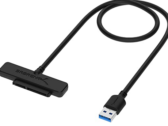

15,504
Why would you need a SATA controller, when you don't have room in that chassis for anything but the four bays that are already handled + the ODD port? Put your boot device on a USB SSD and be done with it.
danny36
Nov 10, 2022
55
like this?

I just now installed truenas on an external USB SSD drive but attached to the internal usb port but after installation I have reboot the server but don't boot from internal usb port.
Whattteva
Mar 5, 2013
1,824
You have to tell the BIOS to boot from USB first.
danny36
Nov 10, 2022
55
yes it is already like this because I had already tried to install truenas on usb stick.

i tried again with the usb stick attached to internal usb port and boot but with a usb 2.5 ssd with case don't boot on internal usb port.
maybe I did something wrong during installation?
