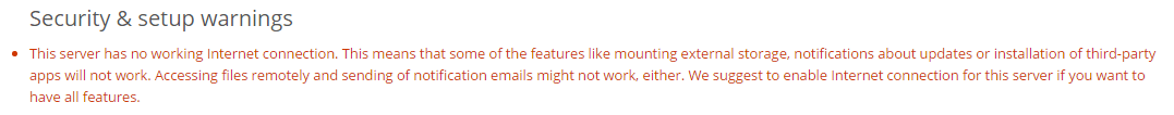

I upgraded to 8.1.1 (Surprisingly BSD and Linux are supported).
Could use some help on this though. View attachment 8406
I just fixed this for myself last night.
Following the Docker config here, I just linked the system CA Root to the desired location.
# ln -s /usr/local/share/certs/ca-root-nss.crt /usr/local/www/owncloud/config/ca-bundle.crt

I'll look into the ca-bundle fix more when I get home. I was typing off a fast response this morning.
I tried pinging google and it worked. I have no problems connecting to the server and uploading or downloading on the browser. All the research I did on the Internet connectivity warning came from people with unresponsive admin pages using older versions of owncloud. So I appogozie if it's not FreeNAS related. I just figured this post is #1 since you all have the same configuration you may experience the same problems.
Thanks for this! Seemed to work.

can you verify if your jail can connect out?
fetch "https://www.google.com"
if so, maybe it's related to the new SSL verification in 8.1.
https://github.com/owncloud/core/issues/17446
I had to
* set "WITH_OPENSSL_PORT=yes" in /etc/make.conf
* stop php, force uninstalled php and php-curl, curl
* recompile the above (and had to unset an option in curl the conflict with using the ports SSL)
* start php
Hi Joshua,
I'm trying to fix the "cURL error 60: SSL certificate problem: unable to get local issuer certificate" issue which from what I can tell is related to OpenSSL. I think your above solution will fix it but what exactly are the commands I need to run? I corrected most of the other issues but not sure how to stop, force uninstall, recompile, and then restart. I've also updated all the ports within the owncloud jail so I think all I need to do is your last three steps. I'm also running nginx and will that also need to be recompiled? Any help would be appreciated so I can get the newest Calendar app running!

Hi Joshua,
I think this should do it.
Add 'WITH_OPENSSL_PORT=yes' to /etc/make.conf
service php-fpm stop
pkg delete -f php56 php56-curl
make install clean -C /usr/ports/ftp/php56-curl
service php-fpm start
I don't remember if I also deleted+recompiled 'curl'.
thefox13
Sep 15, 2014
21
I've tried the above and did not solve the problem so I tried to delete and re-install curl. My issue now seems to be that curl cannot install with the newer OpenSSL with GSSAPI enabled. Once I can figure a way around it, it should work. In the meantime, I've reinstalled the older versions of curl, php56-curl to allow owncloud to run. My latest online findings stated that the updated version of curl should compile with the newer OpenSSL but that does not seem to be the case here and I made sure the ports are update. I'll post updates once I figure it out.
I compiled everything including OpenSSL and PHP and PHP-curl from ports and still had the error. Then i did make reinstall clean from /usr/ports/ftp/curl and the problem went away. You did the curl reinstall from pkg or from ports?
If you do curl --version from the jail you should see OpenSSL/1.0.2d
I hit this error as well, but don't remember what I did. I think I just disabled GSSAPI_BASE then compiled curl.
make config install clean -C /usr/ports/ftp/curl
awesome, so 'pkg upgrade curl' migth do the trick. =]
I don't know. AFAIK pkg upgrade still provides curl compiled with OpenSSL 0.9.8z and if I'm not mistaken to fix this error you need curl with OpenSSL 1.0.1 or higher.
Ahh, I misread your post a bit. So compiling curl fixed it for you?
Actually, the fix requires openssl 1.0.2b+
Yea, compiling from ports with WITH_OPENSSL_PORT=yes (I also compiled OpenSSL before curl but I have no idea if that did anything, I basically complied all of the packages you mention in your instructions just to be sure)
Joshua and Classic, Thanks for the tips. I've ran curl --version and it says OpenSSL/0.9.8z so I will need to make sure to get OpenSSL correct before compiling curl. I'll keep you posted.

21
Classic, curl install from ports is the issue and I am wondering if my OpenSSL is incorrect. I've compiled OpenSSL in /usr/ports/security/openssl with make install clean and then went to /usr/ports/ftp/curl and executed make install clean and still get the same error. Am I missing something with the OpenSSL commands? Thankfully I haven't broken owncloud yet!
you have to go:
first for OpenSSL and then curl ports
after you do so verify curl openssl version with curl --version
and remember that before all of this you have to set WITH_OPENSSL_PORT=yes in /etc/make.conf
PS> if you don't want to brake your Owncloud install just make a ZFS snapshot of your jail. You can then restore it if needed.

you have to go:
I don't think we need to be making openssl.
pkg install openssl should get us the latest one.
but, this is a great explanation anyways!

Hmm..I got the calendar app installed but curl --version still reads the older OpenSSL....not sure what is going on but I'm not going to argue with it for now. Anyway, thanks for all the help!
