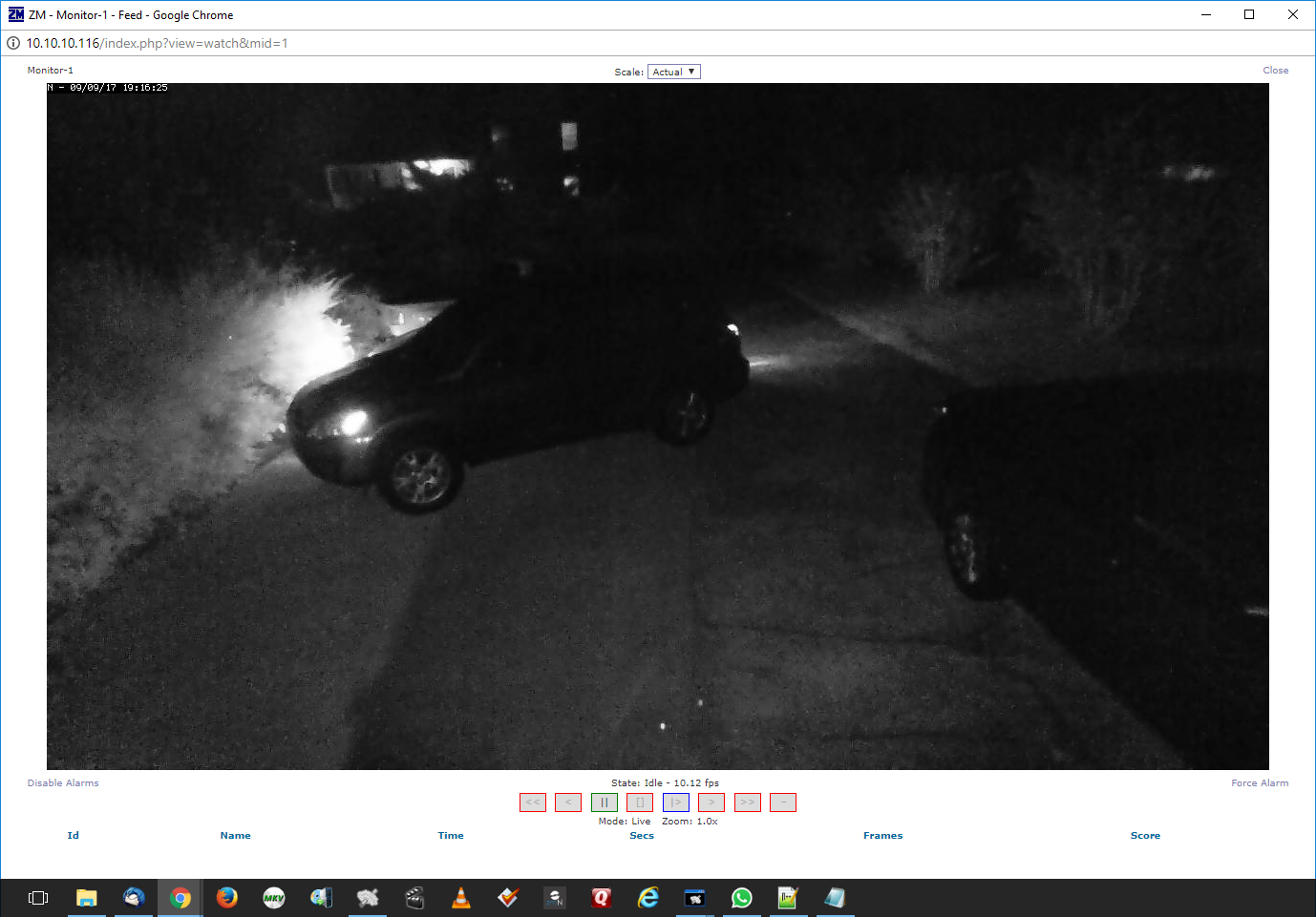

Thank you very much!!!! I spent a lot of time trying to put zoneminder on freenas and now with your guide I succesfully complete this task! Thank you again !
I just connecteda sigle IP 2P2 Cam and works quite well. The motion part works great and I also see snapshots of the event. The only issue that I have is related to the video stream. When I click on the name of cam, a new windows appears with a placeholder for the video stream, under that I have the control buttons (f.forward, play, pause,...) and just undel the list of event.
So I cannot see the video stream from camera, just the placeholder with a green puzzle piece on top left corner.
Do you have in mind what is missing in my system?
Thnak you

So you can see the snapshots but not live stream ... I'd try to talk with the folks on the zm support forum. Post your camera maker/model, the source information (path, port, etc). Also check with the developer for the freebsd port listed on the pdf. He might be able to help as well.
Fabbat
Oct 24, 2013
46
Thank you I've fixed, just put the right resolution (640x480 instead of 320x240, which is wrongly written on paper manula of my cam). Thank you again

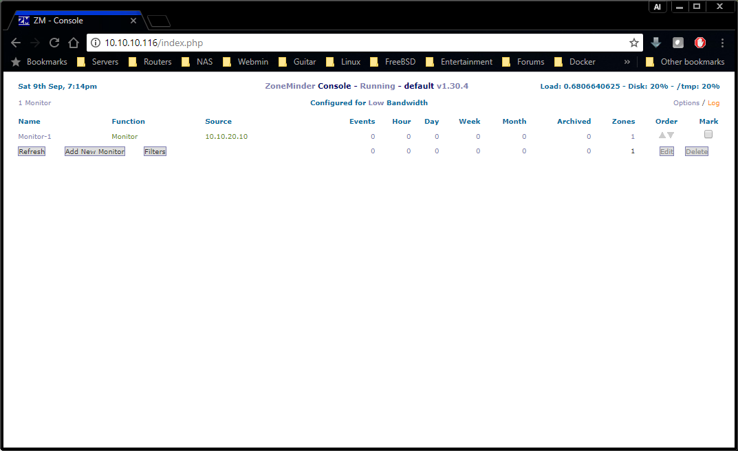

I reinstall on a fresh FreeBSD 11 bhyve VM and got it up and running. Only change was added on step 8.3, as reported above by dev:
root@zminder:/usr/local/etc/nginx # sysrc fcgiwrap_socket_owner="www"
One thing I've noticed was that the issue I saw with joe /usr/local/etc/php-fpm.conf, didn't happen again.
Either way, attached the steps for this test in the txt file (Zoneminder install on FreeBSD 11.txt).

Thanks again. I figured it out. Lack of experience in this type of environment leads n00bs like me to do silly things, like not realize that when you write "find this" in your guide, you literally mean, find something by searching for it using the appropriate tool.
ZM up and running on my FreeNAS box. Now I just need some cameras.
