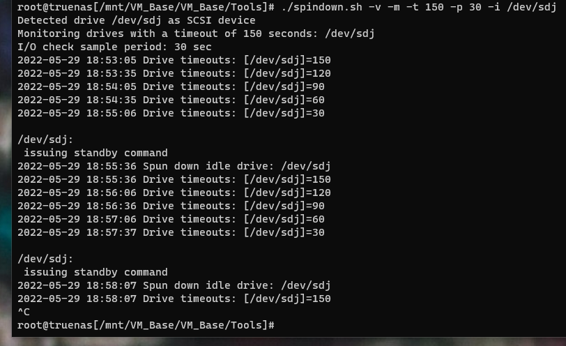

EDIT: OK, so I already found it... FreeBSD uses "extended device statistics" to separate the full list from the idle ones in the iostat output... Debian uses 2 blank lines.
I'll see if I can get something to work with that.

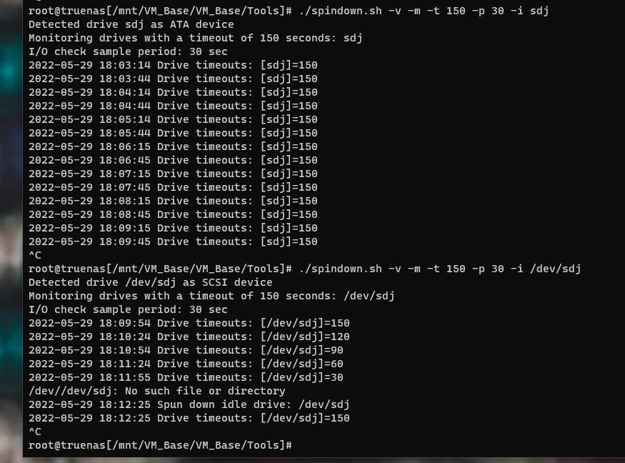

with direct naming its not reading out io/stat correct
with /dev/sdx it does, then spindown would work, just the double dev errors its out.
wbr Alex

OK, so it would seem changing the lines for hdparm to just give the name will be enough... I made an edit to the script again.

And it's right there above the hdparm lines:
function spindown_drive() {
    if [[ $(drive_is_spinning $1) -eq 1 ]]; then

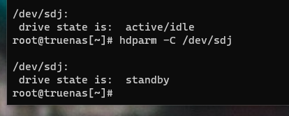

and "drive_is_spinning" is using:
        if [[ -z $(hdparm -C /dev/$1 | grep 'standby') ]]; then echo 1; else echo 0; fi
Which is where the problem is... I'll correct that to not prepend the /dev/
