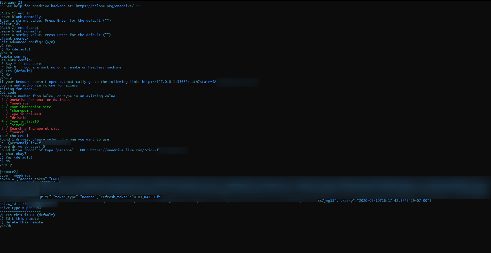

Proof:
Youtube Video I watched and did everything Exact:

With the rclone config screen open, copy the whole access token (including curly brackets, and paste it into the access token field. Right below it on the rclone config screen, copy the drive id and paste it into the drive id field. Use the pull down to set the drive type (personal/business), then verify credential and save.

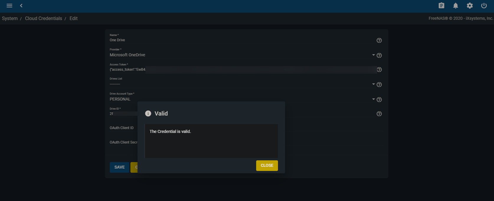

I have already done that.. It some reason doesn't want to work. I have a feeling its the Drive Id because I can't get it from the "Login to Provider" screen.
I copied everything how it should be and still nothing :(
Proof:

I copied {"access_token":"EwB4A to xx7jAg$$","expiry":"2020-09-10T16:17:42.3748429-07:00"}
Then Copied the Drive ID
Set it to personal.
Save and this:

I don't know what you mean by "I can't get it from the "Login to Provider" screen. That erases the drive id and drive type for me.
I think you just want to verify credential and save.
