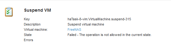

Has anyone ever run into a problem where FreeNAS's VM would refuse to suspend?
"Failed to suspend virtual machine FreeNAS. The operation is not allowed in the current state."

You didn't give any info about your system, so I'm guessing. But you cannot use any of these features if you are passing through (DirectPath I/O) an HBA...
Hot adding and removing of virtual devices
Suspend and resume
Record and replay
Fault tolerance
High availability
DRS (limited availability. The virtual machine can be part of a cluster, but cannot migrate across hosts)
Snapshots

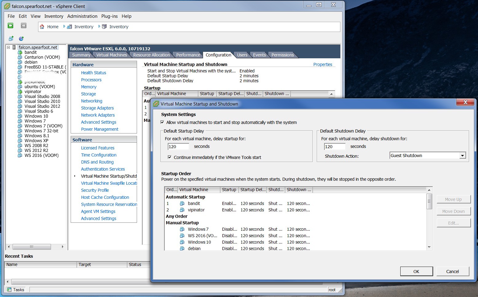

You can configure ESXi so that it will gracefully shut down any or all VMs you choose, including your FreeNAS VM, provided the VMware tools are installed on the VMs, and FreeNAS includes these tools.
Note that you will have to configure this behavior in ESXi because, at least for version 6.0, the default behavior is to simply power down VMs whenever you reboot or shutdown ESXi.
You probably want to configure ESXi to boot the FreeNAS VM at bootup as well.
Here are the ESXi settings on my main system:

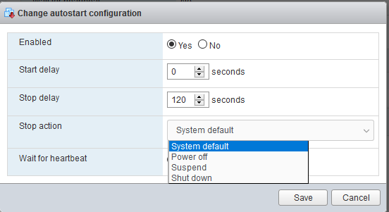

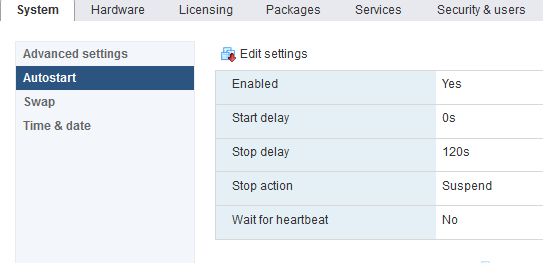

What does gracefully mean?
This is all I could find in v6.7:
No idea if it's possible to actually shut down the VMs like if I was doing it from inside them.
In this context, "gracefully" means exactly what you just said, i.e., ESXi shutting down the VMs as if they were being shut down from 'inside'.

You want ESXi to use "Guest Shutdown" mode with the FreeNAS VM when ESXi itself is rebooted or shut down. ESXi will send a shutdown signal to the VM, which will then go through its standard shutdown processes. As you put it earlier, this is the same as someone shutting down the VM from the 'inside'.
The alternative is for ESXi to simply remove power from the VM, which is equivalent to unplugging the power to a physical server. In general, this is a bad idea for any file server as it can lead to corrupted data and worse, but -- at least in version 6.0 -- this is exactly what ESXi will do unless you change it.
So, referring to the VMware 6.7 document I linked, you want to :
  • Select "Automatically start and stop the virtual machines with the system"
  • Set the "Shutdown action" to "Guest Shutdown"
  • Configure the FreeNAS VM to automatically start & stop with ESXi.
You can make other changes as you see fit, and as required by your needs and setup. ESXi allows you to specify the order in which your VMs start up (and are shut down), how long to wait before starting the next VM in the list, etc., as described in the documentation.
Good luck!
Octopuss
Jan 4, 2019
461
I presume "shutdown" is the same as "guest shutdown" in 6.7.
