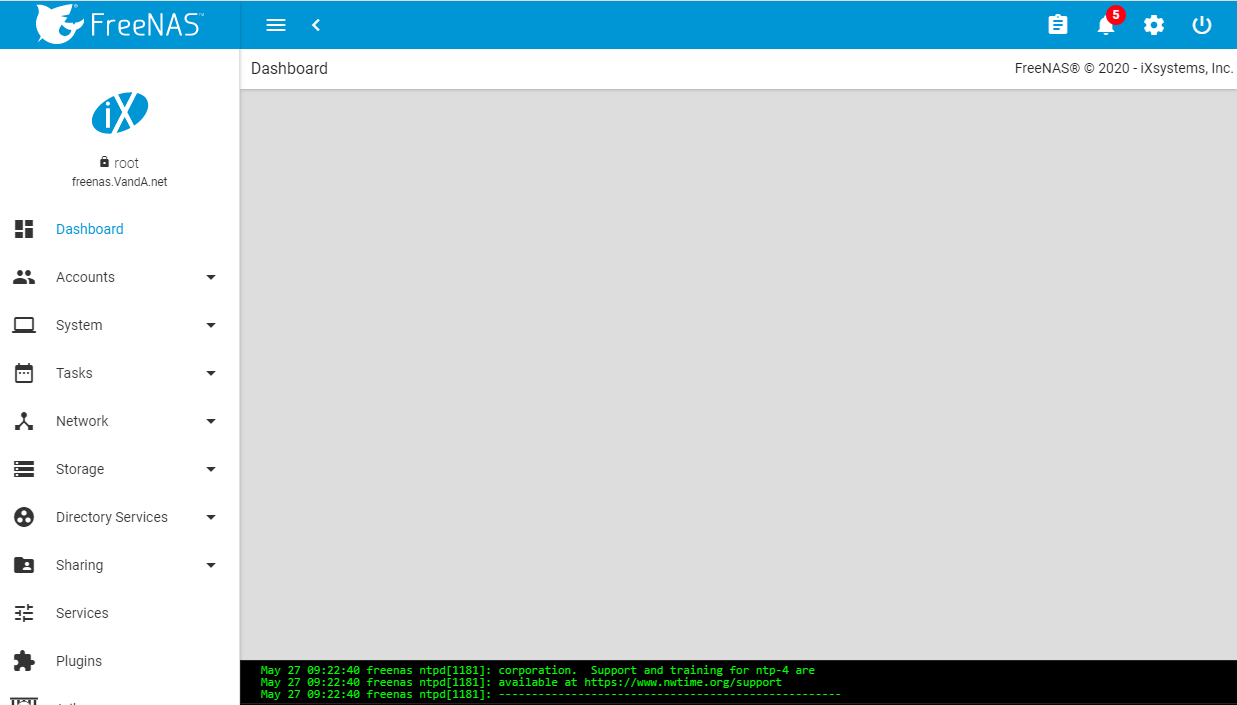

Just updated to FreeNAS 11.3-U3.1. The dashboard is blank. I also get "Web UI HTTPS certificate setup failed" error message. Both issues existed with 11.3.U3.

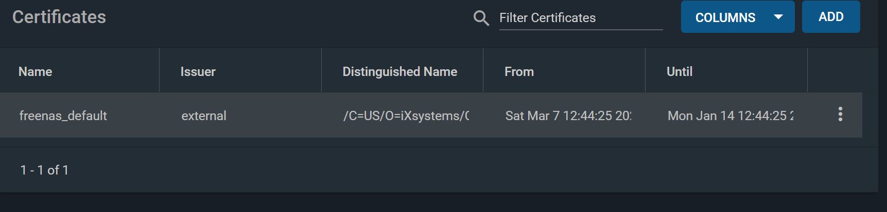

Attached is an image of default certificate. When I try to WebGUI HTTP->HTTPS Redirect box, I get "selected certificate does not have a private key". Please see the attached image.
Well, that's why HTTPS doesn't work, and you're seeing the glitches you do. You may need to fix this via ACME to get a real certificate.

I'm having this same issue.
I normally connect over SSL with the self-signed cert created by the FreeNAS install.
  • This was an upgrade from 11.3-U1 to 11.3-U3.1
  • I have tried clearing cookies and cache on my browser and relaunching it.
  • I have tried other browsers.
  • I have tried a second reboot of the FreeNAS system.
  • All my network interfaces appear to still be recognized (saw someone on the 11.3 U1 thread found this caused their issue somehow).
  • Since I still have plain http connectivity enabled I tried in a Private Prowsing windows (no shared cookies/cache) and tried connecting that way. in case the old cert was causing this. No dice. No dashboard no matter what but other sections of the interface work fine.
