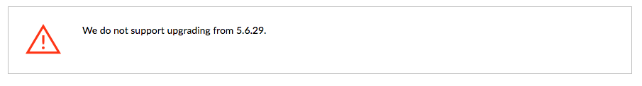

I'm trying this now, and running into two issues. The first is simple; there's an extraneous " at the end of line 25 of unifi-jail.sh. The second is missing " "; they should be around ${JAIL_NAME} in the openssl command in deploy.sh.
Having now succeeded with the installation (and obtaining the cert), I'm now getting this:
I'm thinking the answer is to wipe out what's in unifi/data/ and start over.
15,504
Nope, that wasn't it--the controller wouldn't start. Edited unifi/data/db/version to read 5.6.26 and restarted the jail, and it appears to be up and running. It sees my AP and offers to upgrade its firmware (which I'll probably do later). Good, that's one service moved off the aging VM.
