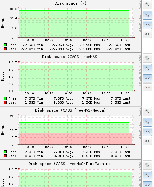

CatSailor
Jun 8, 2017
My FreeNAS box lost power recently (I was running the last release candidate 10 prior to the Corral release) and would not load up. After working on it I determined that now may be a good time to move to RC11. Of course the update failed and I ended up re-installing 11 from scratch.
When I logged in to RC11 it attempted to import my existing ZFS pool and this failed. I currently have a situation where looking at the "Reporting" section it shows my directories, however, i am unable to import the Volumes (in the storage tab) and do not have access to the data. I'm a little freaked out about loss of access to the data any suggestions?
*Edit - Restarted box and the volume was able to be imported. Scary but appears to be working now so all good!
