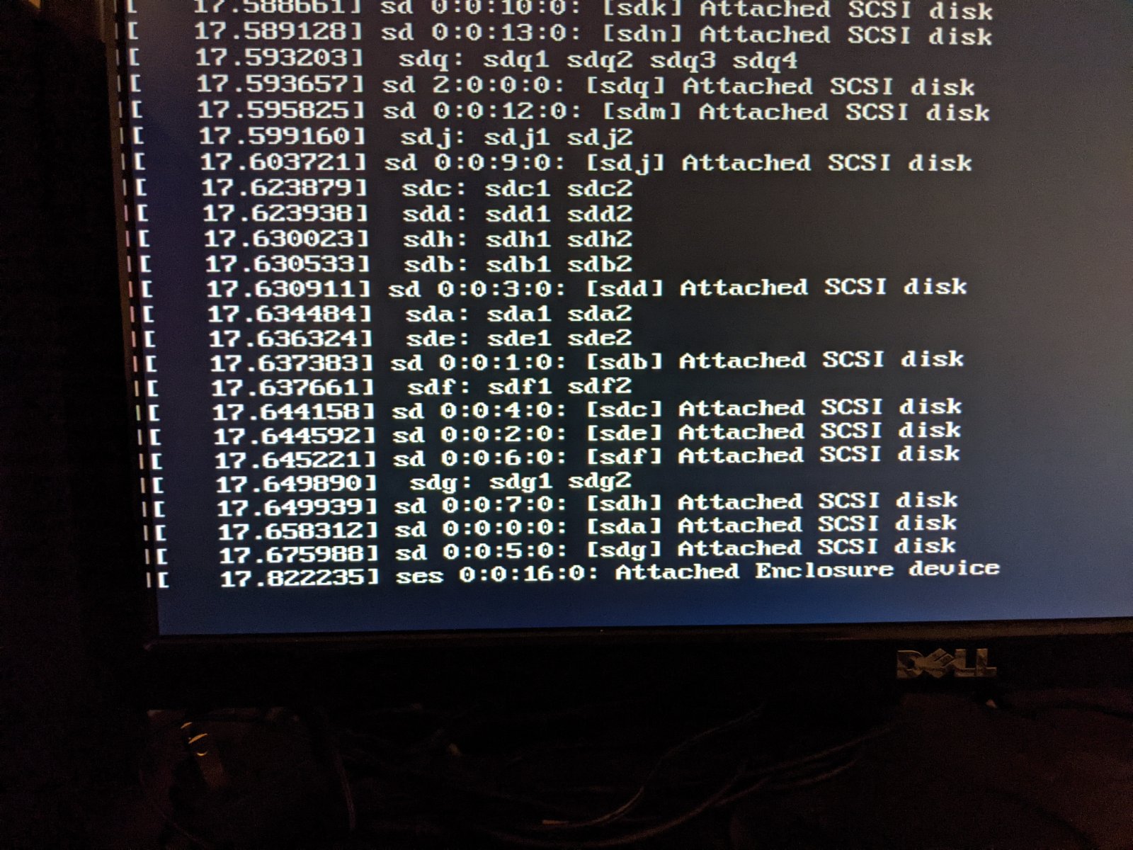

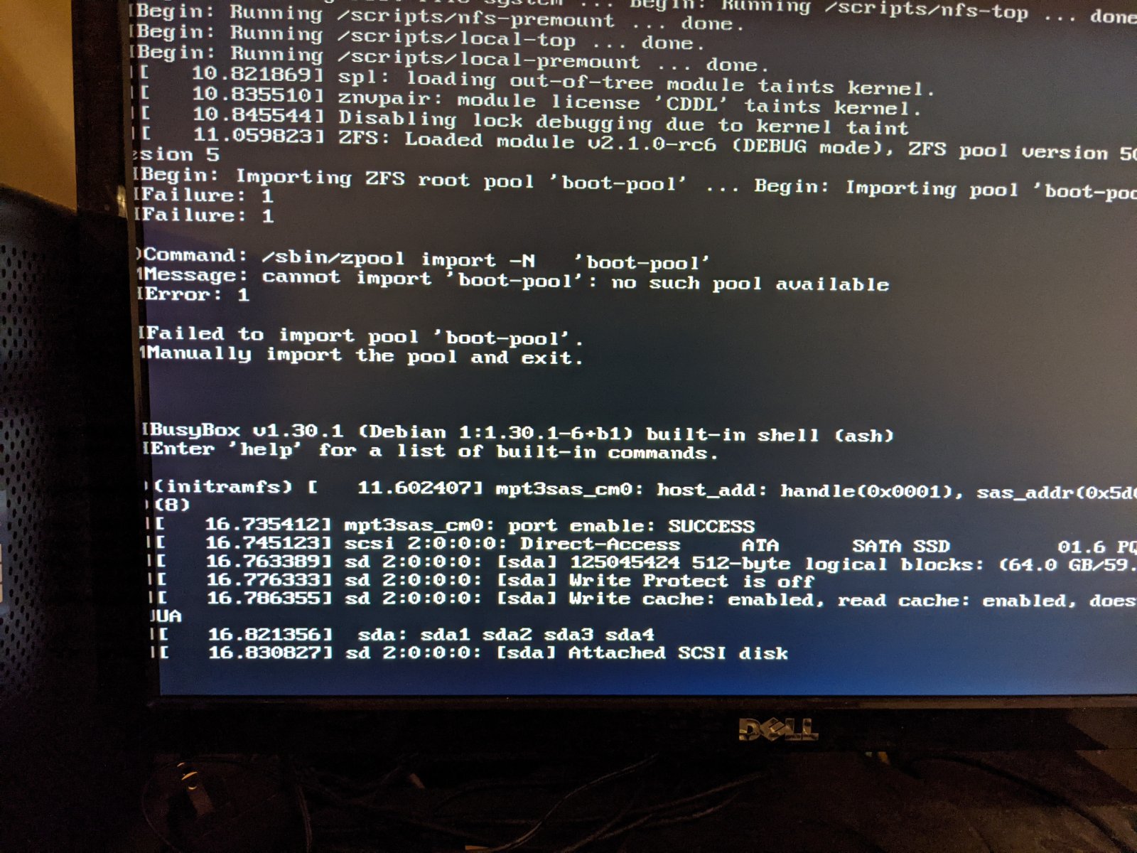

Have an ASROCK (https://www.asrockrack.com/general/productdetail.asp?Model=D1541D4U-2T8R#Specifications) that does only UEFI and had the same issues with the boot volume it would just sit and hang with the cannot import boot-pool (using single SATADOM ) with the Beta.
when i hit enter gave me initramfs then dont know where to go from there....
when i had my sas3 external enclosure setup i couldnt see the error b/c of the inits done on it would just hang but when i disconnected it this is what i saw then found this issue in the fourms...
Storage Controller for SATA is 9172 Marvell - not sure if the others above have a similar combo.
UPDATE: tried the same SATADOM in another machine X9SRI-3F (no Format no changes) booted fine no issues no ask for the above so it seems like its Driver/UEFI related of some sort...
Another thing i should mention boot drive is using the native SATA Ports all be it they are the Marvell 9172 so these should load up with kernel assuming there is a driver, im not booting off the SAS3008 controller at all so i dont think the earlier fixes mean much to this issue. and i tested on an intel controller on the other board and it seemed fine.
