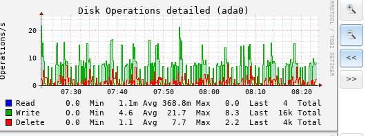

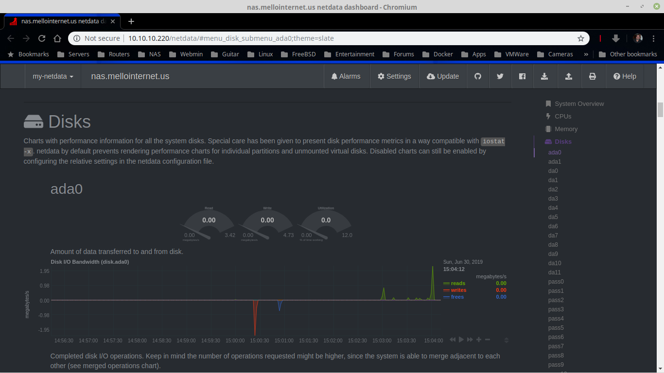

My experience is that there is no activity on my disks activity if the NAS is in idle (and it happens a lot as I'm the only user for it). Enable netdata on services and check disk activities. That will give you an idea what disk is the one in use. I'm not sure the USB boot would show at your Dell activity (I'd assume it won't). ada0 shown below is my boot disk ...

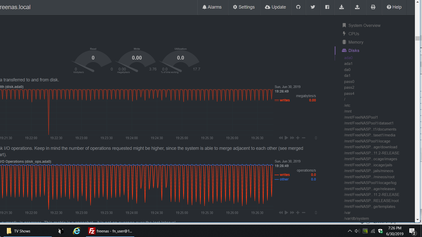

Ok I've definitely got something going on but I'm not sure how to use the tools as my disposal to figure out what it is. This looks the same on both ada0 and ada1. My boot drives show no activity.

The drives on both my FreeNAS boxes show the same behavior - short writes every 5-6 seconds or so. Have done so for a long time. I think I was earlier convinced that this was to be expected if the System Dataset is on the pool as mine is, but I no longer recall the details.

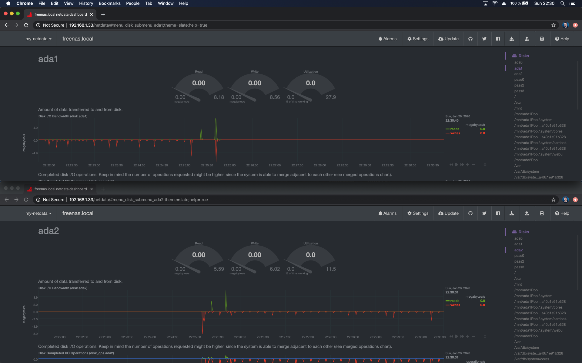

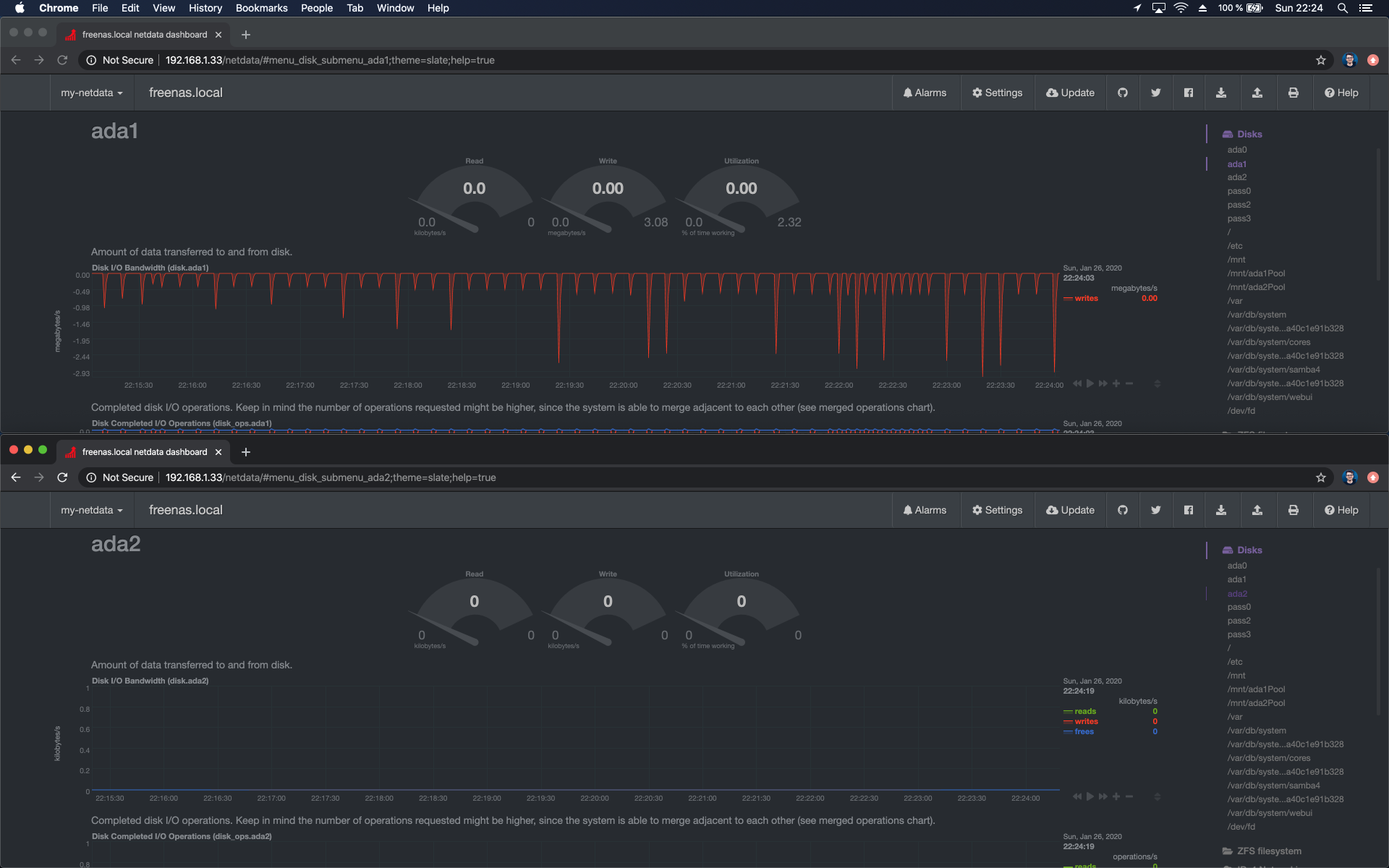

And already after a clean setup (I don't know how cleaner it can get), with no Jails or plugins running, I can see the same activity pattern.
Interestingly, only on ada1Pool.
ada2Pool and the boot drive are virtually idle.
What's more interesting, is that if I export ada1Pool, this activity jumps over to ada2Pool.
And if I import ada1Pool back, the activity remains on ada2Pool.
And lastly, even though no Jails are running in this install, I tried going to the Jails page, and changing the pool under Activated Pool for Jail Manager. This seemed to have no effect.

I think I've got a lead. I went to System / System Dataset and for some reason, the System Dataset Pool was set to ada2Pool.
I opened the drop-down, and there were three options:
- freenas-boot (This must be ada0, right?)
- ada1Pool
- ada2Pool
So I picked freenas-boot, hit Save, and sure enough, ada2 is now idle and doesn't show that activity anymore (and unsurprisingly ada1 is idle too).
I expected ada0 to start showing the same pattern, but it doesn't.. No idea why.
