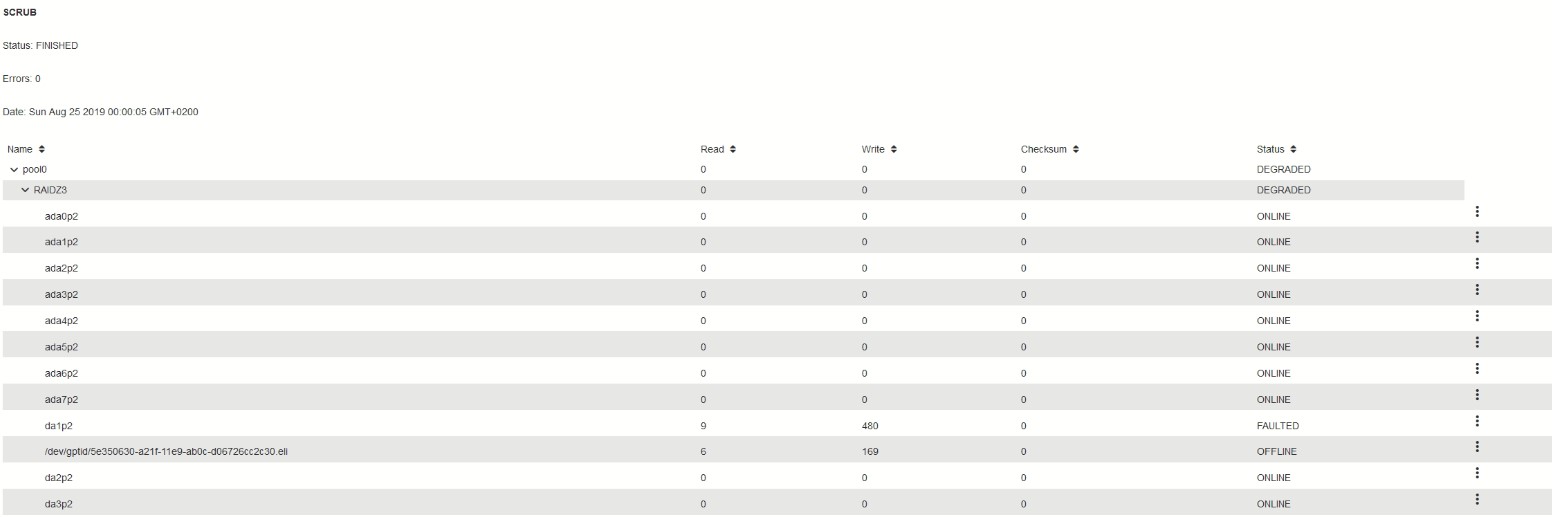

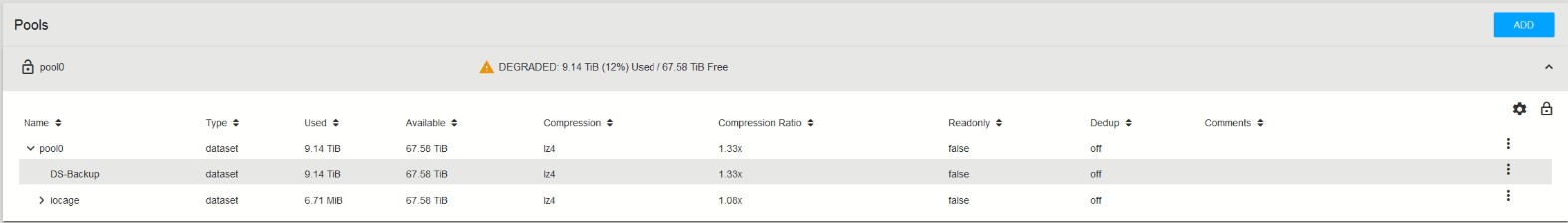

Hello,
on of the disks in an encrypted pool failed and we initiated a disk replacement.
Unfortunately the technician selected the wrong disk to replace.
this is what happened:
- the faulty disk da1 was taken offline in the webui
- the faulty da1 hardware was replaced with a new disk
- now da0 was wrongly logically replaced with da1
- da0 was not faulty
-> now we have two non-functional disks in the pool
- we tried to replace one of the two disks with the now "unused" da0, this did not work (even with the force option, as there was zfs information found on the disk, which makes sense)
- we tried to wipe da0 to get rid of the old remnants, but this resulted in a dd error.
What can we do to geht this pool into a healty state again?
Thank you in advance for your help!

LANtec
Aug 27, 2019
4
No, we were not able to resolve this yet.
Would you be able to help us out?

What is the full output of zpool status (within code tags)?
LANtec
Aug 27, 2019
4
zpool status
pool: freenas-boot
state: ONLINE
scan: scrub repaired 0 in 0 days 00:00:38 with 0 errors on Mon Sep 9 03:45:38 2019
config:
NAME STATE READ WRITE CKSUM
freenas-boot ONLINE 0 0 0
da4p2 ONLINE 0 0 0
errors: No known data errors
pool: pool0
state: DEGRADED
status: One or more devices are faulted in response to persistent errors.
Sufficient replicas exist for the pool to continue functioning in a
degraded state.
action: Replace the faulted device, or use 'zpool clear' to mark the device
repaired.
scan: scrub repaired 0 in 0 days 23:56:22 with 0 errors on Sun Aug 25 23:56:27 2019
config:
pool0 DEGRADED 0 0 0
raidz3-0 DEGRADED 0 0 0
gptid/8a03f9f7-673f-11e9-a7ca-d06726cc2c30.eli ONLINE 0 0 0
gptid/91cf2c42-673f-11e9-a7ca-d06726cc2c30.eli ONLINE 0 0 0
gptid/9994c6bc-673f-11e9-a7ca-d06726cc2c30.eli ONLINE 0 0 0
gptid/a14bc82d-673f-11e9-a7ca-d06726cc2c30.eli ONLINE 0 0 0
gptid/a940b924-673f-11e9-a7ca-d06726cc2c30.eli ONLINE 0 0 0
gptid/b0f5ae62-673f-11e9-a7ca-d06726cc2c30.eli ONLINE 0 0 0
gptid/b8e58157-673f-11e9-a7ca-d06726cc2c30.eli ONLINE 0 0 0
gptid/c0c8d298-673f-11e9-a7ca-d06726cc2c30.eli ONLINE 0 0 0
gptid/5f4b2fa9-c410-11e9-a95f-d06726cc2c30.eli FAULTED 9 480 0 too many errors
7190436734433225016 OFFLINE 6 169 0 was /dev/gptid/5e350630-a21f-11e9-ab0c-d06726cc2c30.eli
gptid/7e7e3d93-a21f-11e9-ab0c-d06726cc2c30.eli ONLINE 0 0 0
gptid/e8d5d471-673f-11e9-a7ca-d06726cc2c30.eli FAULTED 6 446 0 too many errors
D
dlavigne
Guest
Does replacing the 2 problematic disks with new disks resolve the issue?
