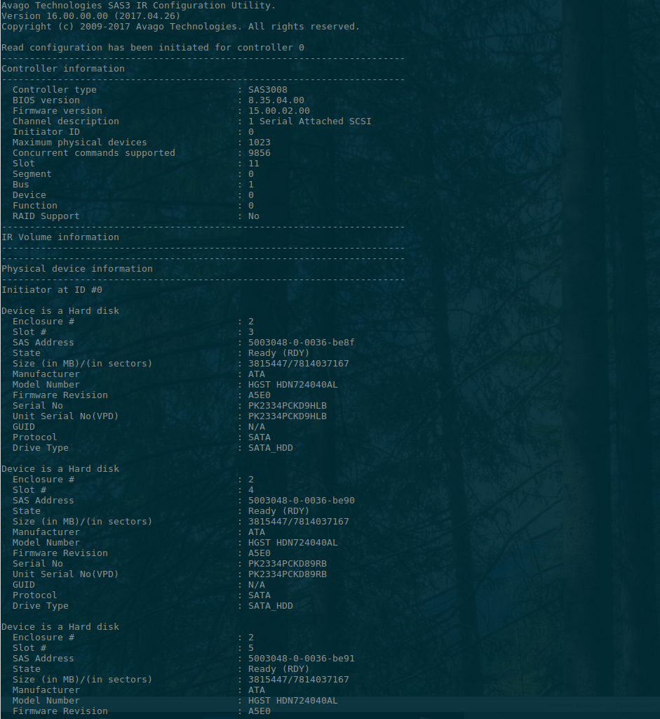

I hope no one minds me waking this thread back up.
I tried the script and it didn't make the LED for the drive I took offline blink and every time the script ran it sent an email whether the drive was online or offline.
I was hoping to get some help with the script. I don't know much about scripting and I have looked the script over.
I'd like to disable the email notifications as FreeNAS sends a email notification anyhow when a pool degrades and only have it blink the RED LED of the drive in question.
I plan to put a couple drives in my system for testing and will obviously degrade that pool to see if the script works.
Any chance of getting some help?
Edit: Oh! I forgot to add that I'm using SAS3 so I changed the sas2ircu to sas3ircu within the script.
As for my prior post, apparently I was using a older version of the script which was causing problems.

What do you get on your system with sas3ircu 0 display?
Visseroth
Nov 4, 2011
546
It looks similar, but maybe I'm not seeing where it's different?...
sas3ircu 0 display
Avago Technologies SAS3 IR Configuration Utility.
Version 16.00.00.00 (2017.04.26)
Copyright (c) 2009-2017 Avago Technologies. All rights reserved.
Read configuration has been initiated for controller 0
Controller information
  Controller type						 : SAS3008
  BIOS version							: 8.35.04.00
  Firmware version						: 15.00.02.00
  Channel description					 : 1 Serial Attached SCSI
  Initiator ID							: 0
  Maximum physical devices				: 1023
  Concurrent commands supported		   : 9856
  Slot									: 11
  Segment								 : 0
  Bus									 : 1
  Device								  : 0
  Function								: 0
  RAID Support							: No
IR Volume information
Physical device information
Initiator at ID #0
Device is a Hard disk
  Enclosure #							 : 2
  Slot #								  : 3
  SAS Address							 : 5003048-0-0036-be8f
  State								   : Ready (RDY)
  Size (in MB)/(in sectors)			   : 3815447/7814037167
  Manufacturer							: ATA
  Model Number							: HGST HDN724040AL
  Firmware Revision					   : A5E0
  Serial No							   : PK2334PCKD9HLB
  Unit Serial No(VPD)					 : PK2334PCKD9HLB
  GUID									: N/A
  Protocol								: SATA
  Drive Type							  : SATA_HDD
  Enclosure #							 : 2
  Slot #								  : 4
  SAS Address							 : 5003048-0-0036-be90
  State								   : Ready (RDY)
  Manufacturer							: ATA
  Serial No							   : PK2334PCKD89RB
  Unit Serial No(VPD)					 : PK2334PCKD89RB
  GUID									: N/A
  Protocol								: SATA
  Enclosure #							 : 2
  Slot #								  : 5
  SAS Address							 : 5003048-0-0036-be91
  State								   : Ready (RDY)
  Manufacturer							: ATA
  Serial No							   : PK2334PCJAX5AB
  Unit Serial No(VPD)					 : PK2334PCJAX5AB
  GUID									: N/A
  Protocol								: SATA

Chris Moore
May 2, 2015
10,079
So it seems sesutil kind of works and does accurately point out the drive when it does work. At least in this testing instance it did, though it doesn't see all my sas ports or drives.
I am only just beginning to look into this myself but I wanted to share what I found on my system.
Here is an excerpt from one of my log files:
Mar 17 16:27:16 Emily-NAS ses0: da17,pass19: SAS Device Slot Element: 1 Phys at Slot 23
Mar 17 16:27:16 Emily-NAS ses1: da20,pass22: SAS Device Slot Element: 1 Phys at Slot 23
When you have two backplanes, they should be ses0 and ses1 as seen above.
The command to light up a drive bay would be: sesutil fault -u /dev/ses1 23 on
In the log you see that da17 is in slot 23 of ses0 while da20 is in slot 23 of ses1
I will do more investigation on how this works, but I thought that might help.
Visseroth
Nov 4, 2011
546
Interesting. I didn't think there was more than one path for that command to light up a fault light. Then again, I still feel like a bit of a FreeBSD/Linux noob.
It's interesting that yours gave you the ses# location.
What command did you use to get that output?
I used sesutil map.
I tried sesutil map -u /dev/ses0 and received the same output as listed above but if I try sesutil map -u /dev/ses1 I receive "sesutil: No SES devices found"
Chris Moore
May 2, 2015
10,079
My backplanes are probably different because they are Chenbro instead of Supermicro or it could be that each of them is cabled directly to the SAS HBA. I know that the SAS controller at work lists a separate ses id for each of the external drive shelves in the rack. I also know that Supermicro has had some issues with their backplanes not being properly configured from the factory.
Visseroth
Nov 4, 2011
546
ahhh! Now you're just showing off!!! LOL
Never heard of Chenbro!
I took a look at the link for your chassis, not pretty from the front but it looks to be well utilized space! (And better priced!)
Well makes me wonder if there's a firmware update for the backplane. Guess I'll need to look into that and it makes sense that each backplane has it's own ses ID.
Good to know about issues with the backplanes from the factory!
And my backplanes are (as well) plugged directly into the sas controller. I didn't see why I should waste the extra lanes since they currently don't have another use at this time.
Still though, I think the sesutil command brings the FreeNAS team one step closer to being able to put a button in place to light up specific drives for maintenance!
