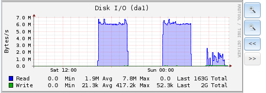

Does one need to reboot the server or just restart CIFS service for the benefit to be seen? I am not seeing an improvement with #4.
Image shows one disk with a file of the same size of file before and after on the right. I canceled the 2nd transfer when it kept dropping in transfer speeds.
I was copying from one FreeNAS to another. The server build is in the header and identical for both units. Win7 box acting as CIFS client.
Any ideas?
These parameters do not affect file transfer speeds. It only affects the speed of directory listing on a CIFS share. If you are having an issue, please start new thread.
