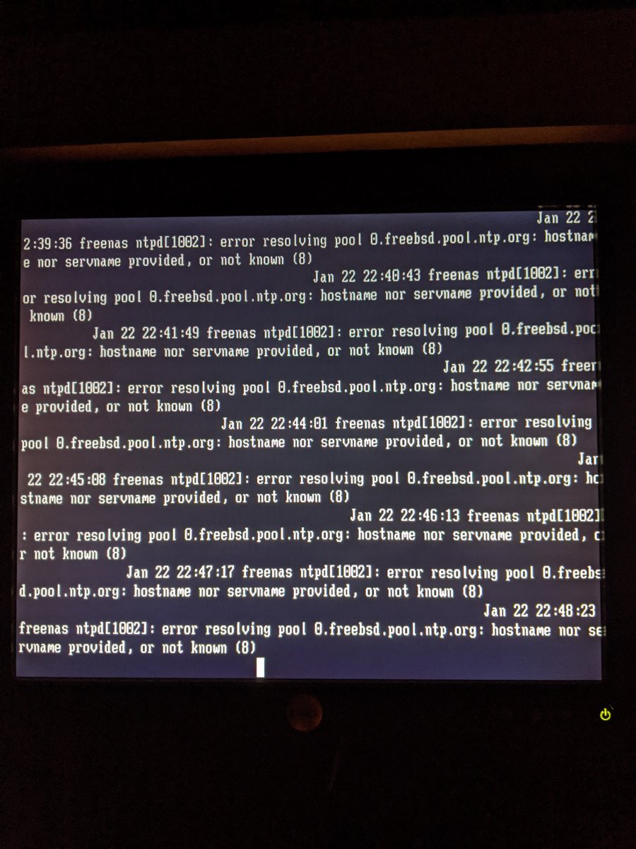

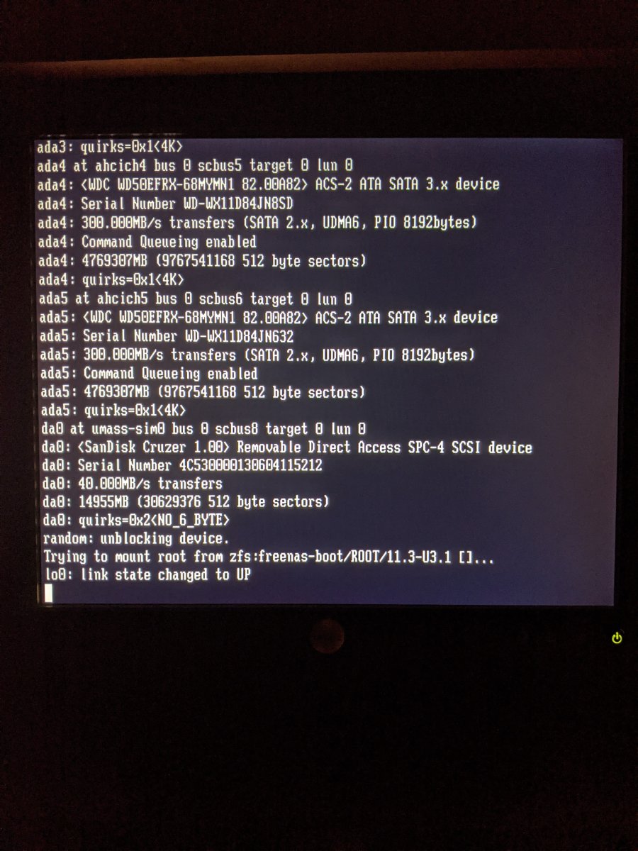

After installing the NIC the boot sequence gets stuck for a while on this screen here, and then it finally finishes booting

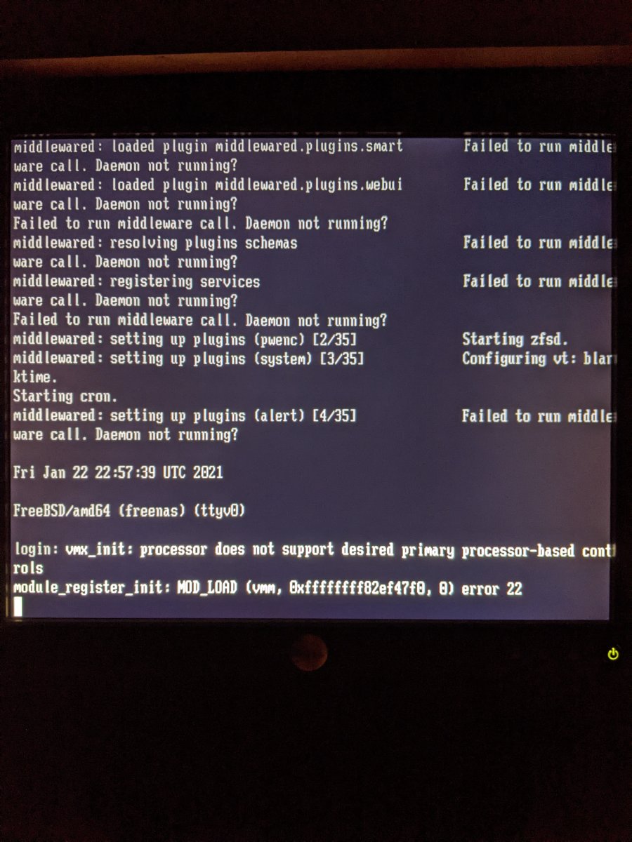

Once it's done, it gets stuck here:

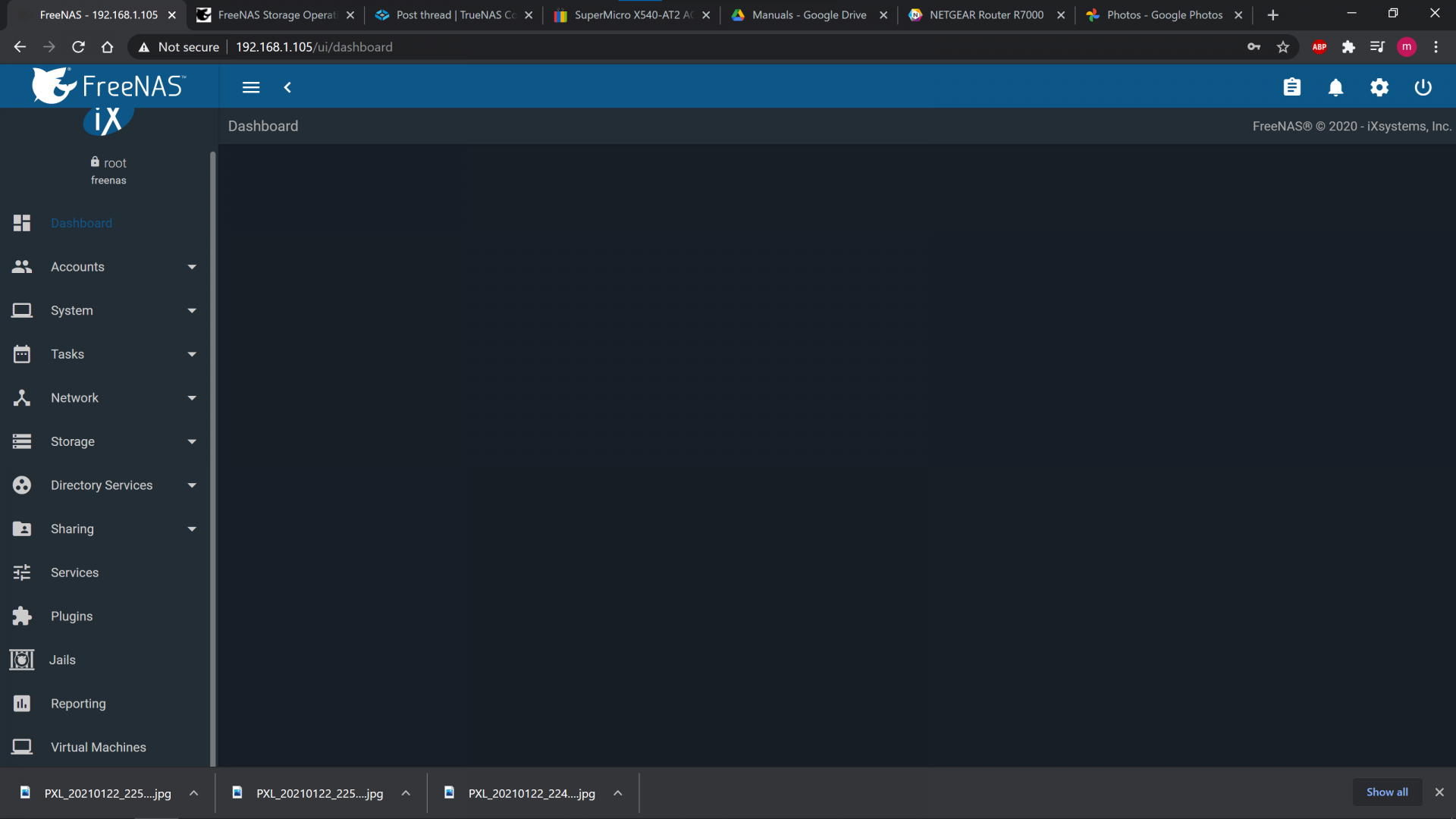

When I load the web gui, it works, but there is nothing on the dashboard page:

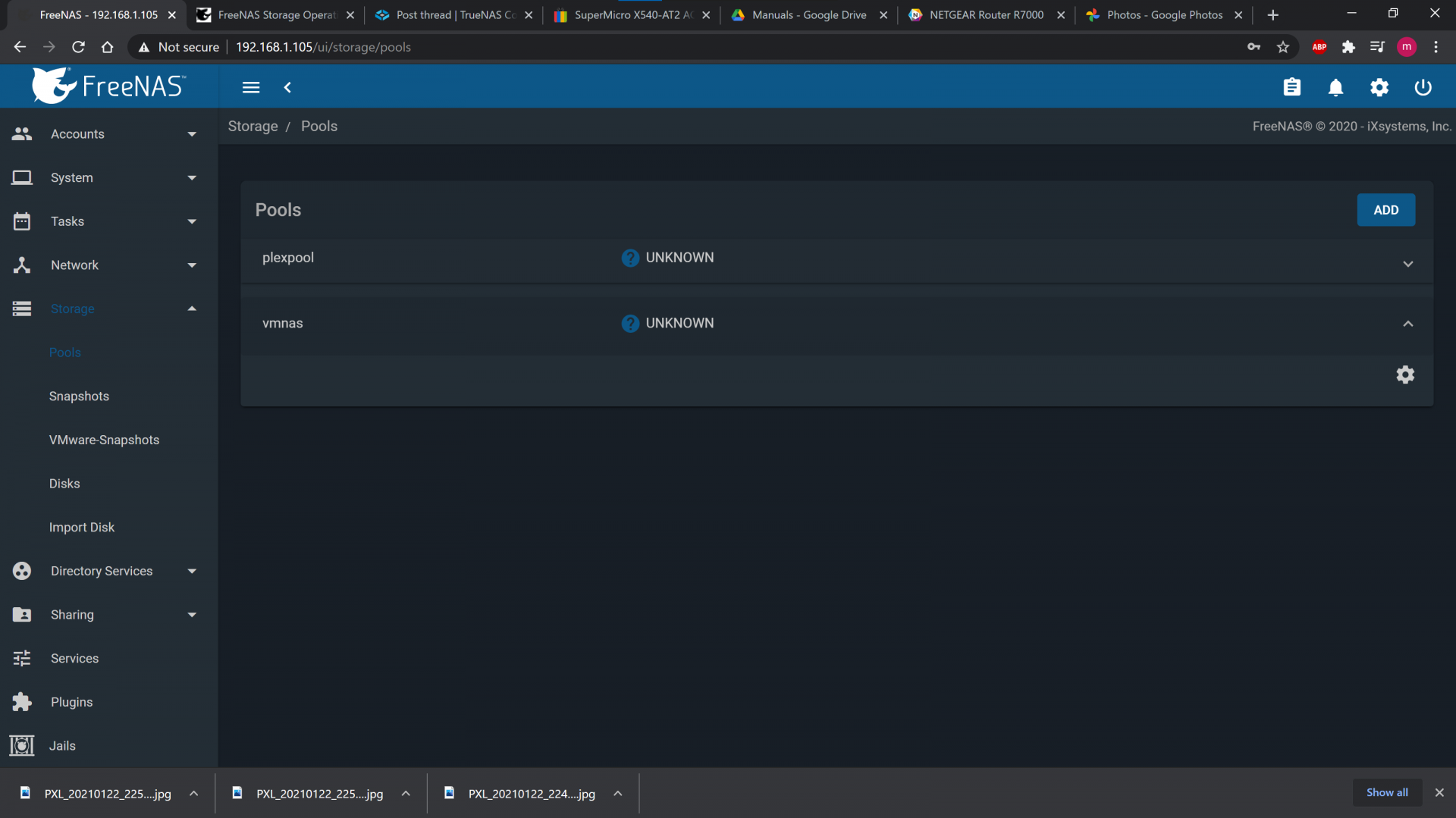

and my pools and datasets are gone:
Shutting down and unplugging the 10 Gb NIC and rebooting without it yields the same problem. I restored to a config file I made before the install and still have the same problem. Help! What do I do to get my pools back online? Why would booting with a NIC installed screw up my pools and datasets?

You will probably need to provide some more information such as what the output of "camcontrol devlist" is and what happens if you try to import the pool.

I am anything but an authority on this subject, but......when I was dinking around with my main freenas box upgrading from 9.10 -u6 to 11.3 , ultimately to truenas 12.0-u1, I experienced the same issue with my pool. You did not loose any of your data. Take a deep breath, and since you have the last good config file, simply reload a fresh copy of 11.3 onto your boot drive, boot up and import pool....update config. or maybe drop down to 11.2 and upgrade back to 11.3. I do not /did not understand what I did as to why this worked, but my feeenas box just needed a good kick in the arse.

Seeing those messages about failures with middlewared, I wonder if your install of FreeNAS has become corrupt somehow?
As @ccssid points out you likely haven't lost any data. That'll still be on your drives, it's just the OS is having trouble working for some (so far) unknown reason.
If nothing else works to get things happy again, as a diagnostic step you can try installing FreeNAS to a USB stick and booting with that. If that works, then it would help clarify whether the problem really is a corrupt installation or not. :smile:
