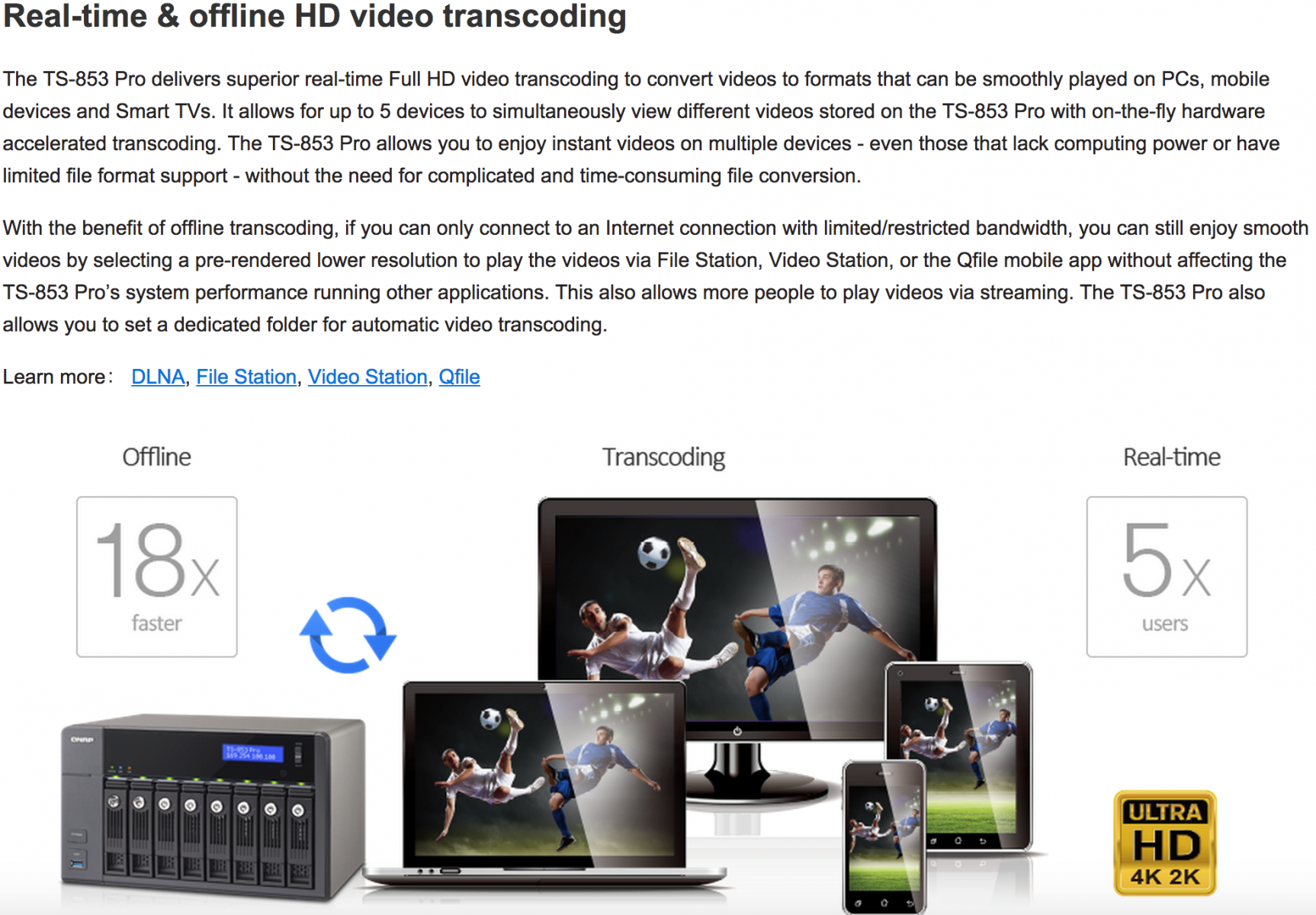

That's what they say. http://www.qnap.com/i/en/product/model.php?II=151

Notice qnap specifies up to 5 devices. That is a maximum and doesn't specify resolutions.
bestboy
Jun 8, 2014
198
It allows for up to 5 devices to simultaneously view different videos stored on the TS-853 Pro with on-the-fly hardware accelerated transcoding.
Yes, but you will have to use their own streaming service "video station" and their special mobile apps "QFile" and "QVideo".
If you want to use Plex on the QNAP as stated by the topic "Building a server for Plex", then you are limited by what the QNAP can do with software transcoding.
If Plex is not a must, and you can get those QNAP apps running on your Rokus and various end devices, then you might be able to benefit from the hardware transcoding.
