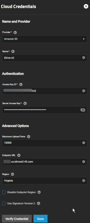

If you use iDrive e2, you can backup TrueNAS SCALE using a Cloud Sync task under Data Protection.
In iDrive e2 (a different iDrive service than the original iDrive), create a bucket and then add an access key. That will give you a region, url, key, and secret.
In TrueNAS SCALE go to Credentials->Backup Credentials and click to add a cloud credential. Choose Amazon S3 for the provider, then add the region, url, key and secret.

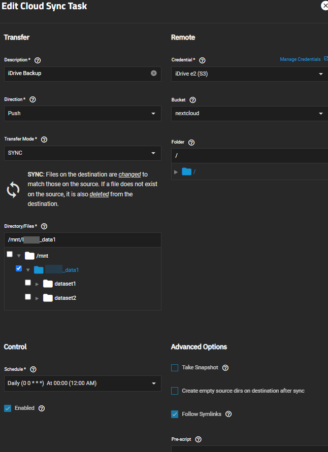

Save the credential and go to Data Protection to add a Cloud Sync Task. Select your credential you just created, fill out your other settings. I was getting an error until I clicked 'Follow Symlinks." That is the only advanced option I changed.

How did you setup your cloud sync task? I keep getting an error on dry run:
[EFAULT] Errors: 2 (retrying may help) Transferred: 23220 / 23220, 100% Elapsed time: 2.7s Failed to sync with 2 errors: last error was: not deleting files as there were IO errors

I glad I could help. I provided a screenshot of my cloud sync task. Let me know if something is unclear about that. The exact screenshot provided actually failed. It worked when I chose a subdirectory (dataset1) to the primary dataset, which is selected in the screenshot.
