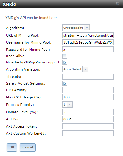

Hmm. Could be, I just rebooted but I am still capped at 180. Care to share your settings? Are you saying that when you rebooted that you went up to 280 but then dropped again after a while?
basically all my settings were default except 'cpu affinity = 0x55'.
I used algorithm variation 1(Hardware AES). I'm not sure if you tried forcing different algorithm variations, but that might change things as well.
So for my e3-1240v2 system, it is actually a FreeBSD server I use to host some stuff, including my security camera system (zoneminder), in a jail. Which uses alot of cpu cycles since it is analyzing 5 HD camera streams. I temporarily disabled zoneminder to test my max hashrate on the system. I noticed I was getting 280h/s on the system, but when I ran xmrig in a jail I got 160-180h/s max. I was confused, tweaking everything, but after rebooting I got 280h/s in a jail as expected.
That was at least a week ago, unfortunately I don't know what hashrate the system can currently max out at, since I normally run zoneminder which keeps the system is busy, and I get 100h/s or less.
It doesn't sound like rebooting does anything in your case, my case might have been something else unrelated, or specific to my setup.

EDIT: after playing around with settings, it seems it is not recognizing my 8 threads. It is only using 4 of them (as is show by my hash rates per thread in the settings page of the plug). Strange. If I change it to 2 threads, it uses 2. If I change it to 4, it uses 4. If I change it to 8, it uses 4. Hmmm?
Remove the 0X55 setting. That is forcing it to only use 4 cores. If you want it to use more cores you have to either remove it or increase the number of cores used.

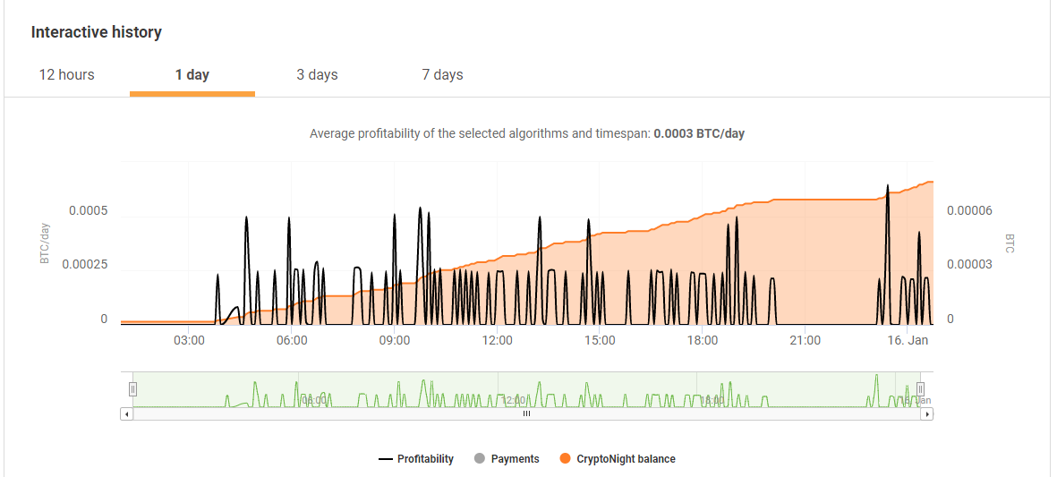

Hmmmm. So I've had mine running for almost 24 hours and nicehash seems to report 0 hashes/second about 50% of the time, even though I can see 350H/S locally consistently. Any thoughts, anyone?
Joshua Parker Ruehlig
Dec 5, 2011
5,949
View attachment 22378 View attachment 22379
I haven't tried out nicehash yet, but maybe it is only accepting your hashes in bursts? I'd check to see what your average hashrate is on nicehash's site and make sure it makes sense with what your miner is submitting.

Since this seems to be a good place to share. Is everyone else in this thread who is currently mining with this plugin seeing wide variations over time of hashrates? I don't know if this is the nature of mining cryptocurrency (my first time doing it) or if it has something to do with my system. Screenshot for reference:
Nucshuco
Aug 22, 2014
52
Yes I am
Apr 9, 2015
1,258
Yes that is how ALL mining works. Your system will have variations on the speed depending on the difficulty that is given to you. The remote system will also have windows where they average everything together so the chart is just fine. The number you really want to look at is your 24 hour average when you start figuring how much you make.
