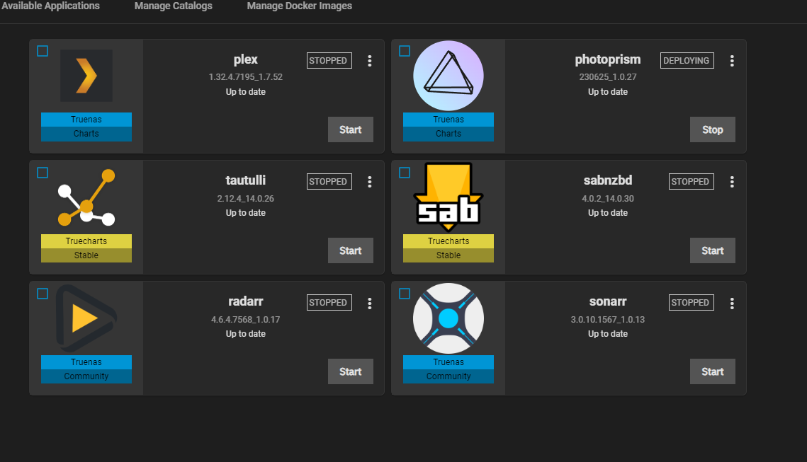

Ive been having loads of stability issues with pods for the last 24 hours, now NONE of them will even deploy. Seems like truenas scale can be sensitive to rebooting gracefully, which is concerning as this all started after a issuing a "reboot" on the command line (with all apps stopped).
Any app I try has the exact same issue.

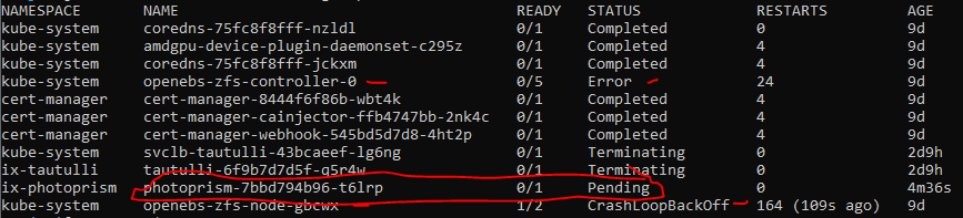

I have attached the logs for the pods that have crash in these 2 files:
sudo k3s kubectl logs openebs-zfs-controller-0 --namespace kube-system > /mnt/CHUNK/openebs-zfs-controller-0.log
sudo k3s kubectl logs openebs-zfs-node-gbcwx --namespace kube-system > /mnt/CHUNK/openebs-zfs-node-gbcwx.log
I dont know how to get the logs for pods that refuse to start, i dont believe even know if its possible (i dont think so).
My apps
Can you please help me troubleshoot? I have read the other threads and it seems to be a common issue. I have found no solution. I have attempted to boot into previous versions with no joy, same exact issue on all previous versions. I have even tried to role back the apps in order to see if they will finally start, no joy.

I deleted photoprism and reinstalled it, exact same behavior. I think something on the OS side is pear shaped. :(

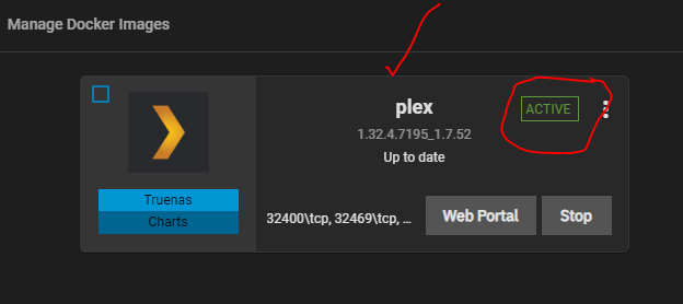

reinstall alone didnt help - i had to wipe out the drive the apps were on - but having a plex config helped as I didnt have to configure anything
