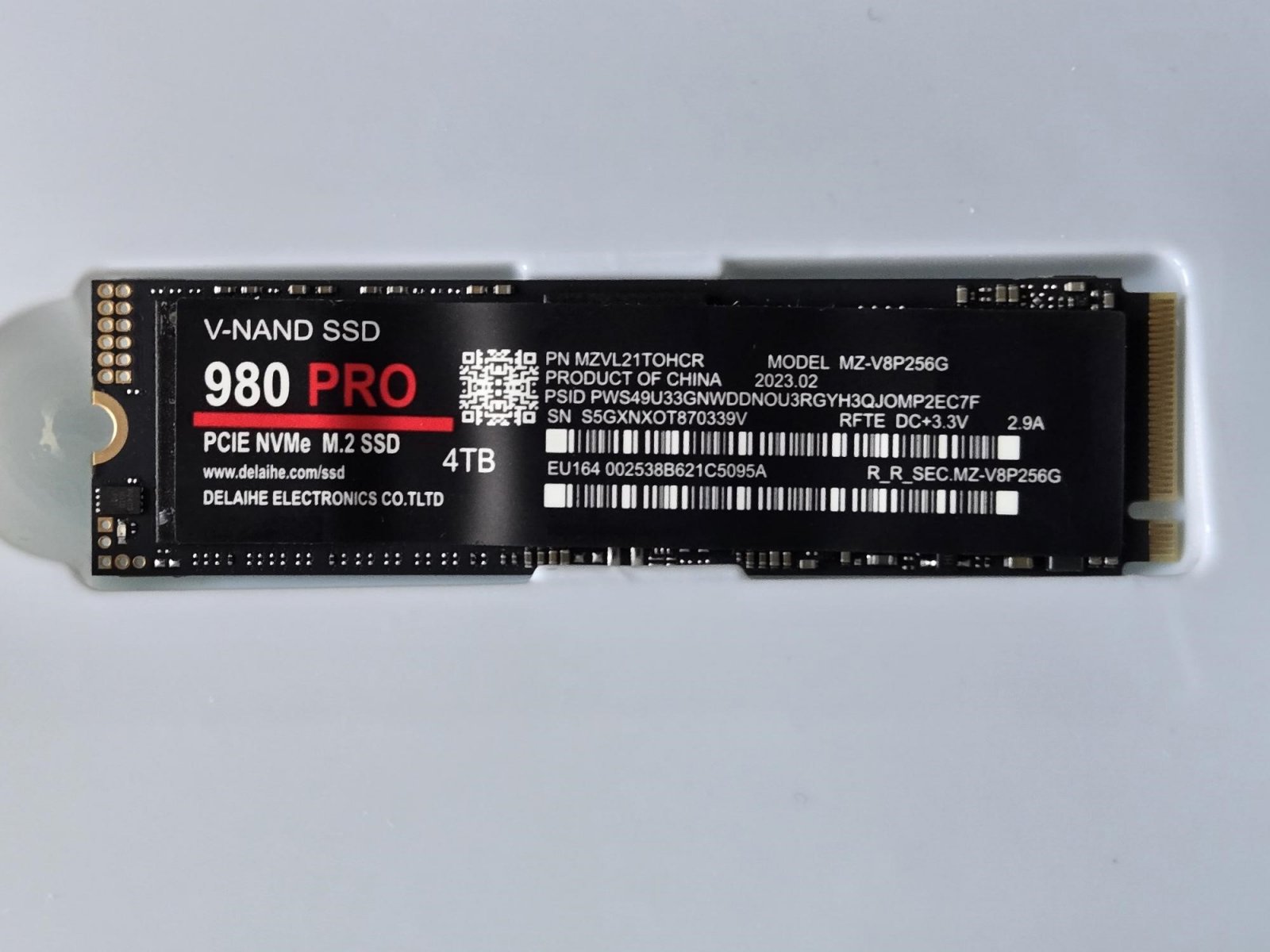

Well the NVMe came in and it was pretty fast delivery as well (3 weeks from China). Here is what I got.
Looks like a Samsung, ALMOST. It does not say "Samsung" and has a different web address "Do not visit it, unless you want a virus". I used my Sandbox so I would stay safe, and it was a good thing.
The PN even has a Samsung number. And yes, not 8TB, but had this been a real Samsung 4TB drive, I'd have been fine. Samsung Magician did not recognize it either.
I did test it out and here are my results:
1) The firmware report the model as a 4TB SSD, the SN is 000024. When I first looked at the serial number, I knew the jig was up.
2) Tried to run a Self-test, it refused. Another red flag.
3) I did a transfer of speed test (in an external USB enclosure) and it was on par for the enclosure (~420 MB/s Read, ~363 MB/s Write), nothing really fast but I am hesitant to install in my computer to do proper testing.
4) After I transfered 169GB of data to the drive (the transfer started really good but after a few minutes it slowed to a crawl) I did another throughput test and it was horrible (~20MB/s Read, ~9MB/s Write).
5) But wait, there was one other special feature. As I continued to add more data, I'm watching the available capacity drop but suddenly it jumped up. This drive has the "April Fools Deletion Protocol" enabled, apparently it thinks everyday is 1 April. I suspect they faked the firmware out to just start all over again with respect to the memory chip addressing.
6) I have initiated a WIPE using Partition Magic, I would not trust the nvme secure erase command. It will take some time but that is okay.
What am I doing now?
Well I have filed for a refund from AliExpress and the return should cost me nothing, and it was fairly simple. It will likely be a month before I see my money back.
If AliExpress does not play ball, I will file a claim with PayPal and be sure to get my money back.
What did we learn from this? Watch out what you are purchasing. I was not upset about what showed up but I was excited when I first looked at the nice shiny new Samsung 980 Pro 4TB drive for just over $60 USD, great deal, that is what my brain saw initially, until testing started and then I was a little disappointed. I will not purchase from AliExpress again, I'd rather use NewEgg, B&H Photo, or some other place that I've had good luck with and has a great return policy. To be fair to AliExpress, I have previously purchased from them a few times, I received exactly what I ordered and no complaints.

Funny how the QR code looks like, Its more of an art piece than anything else.
That is so true, I didn't even notice it. Now that I'm thinking of it, it was strange that when I was snapping off the photos, the QR code didn't pop up wanting to go to a website.
That's because it's not a QR code! It's a crap imitation of one (the first giveaway is that QR codes have one corner with a smaller, different calibration square, so the reader can determine the orientation).
