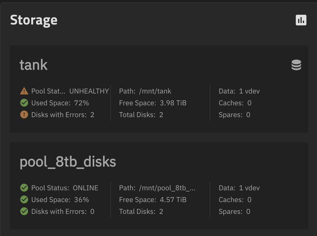

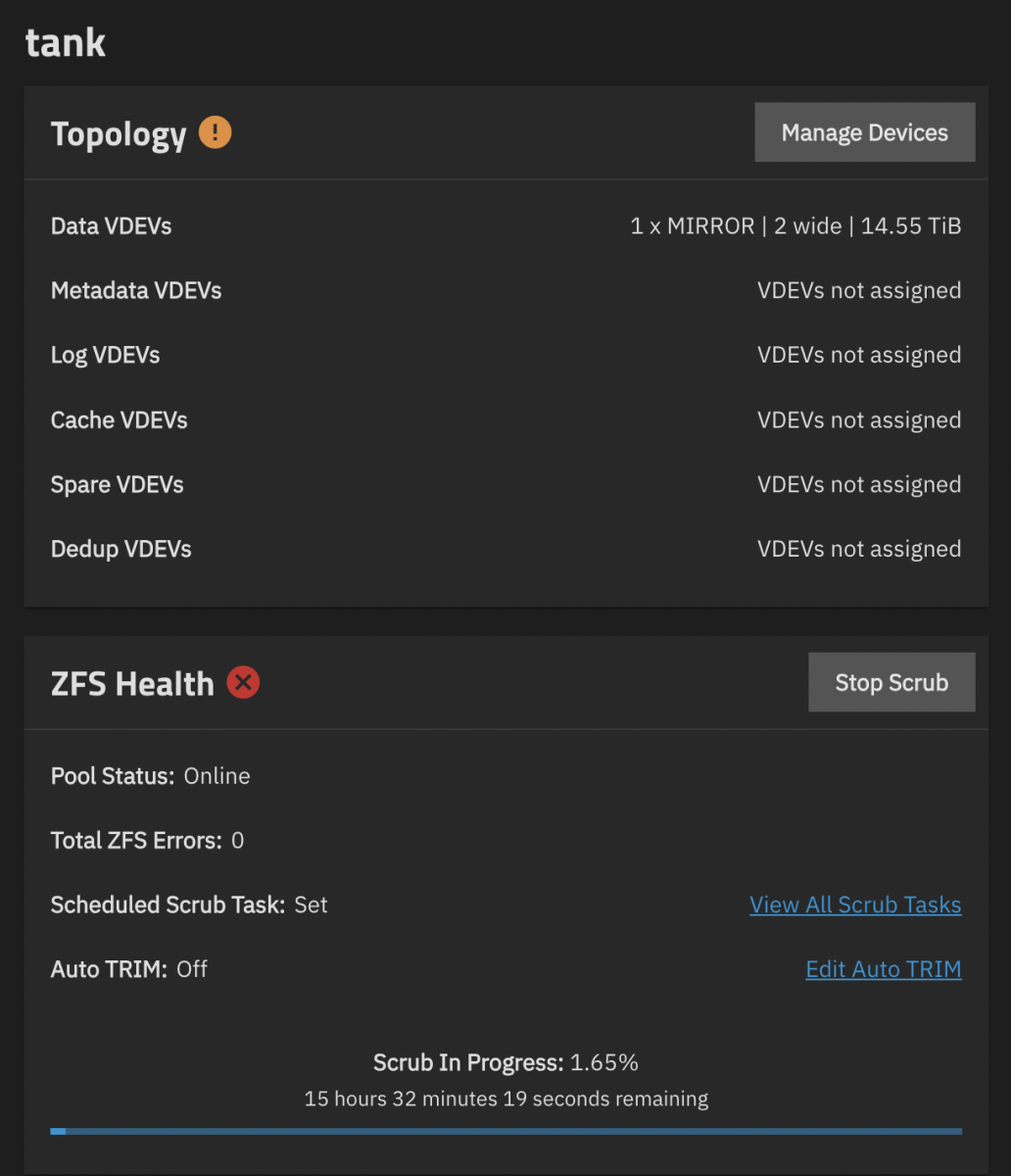

Disks are just a year old, the message "Pool is not healthy" is not exactly a great description of what is wrong.
Anyone have an idea to what I should do?

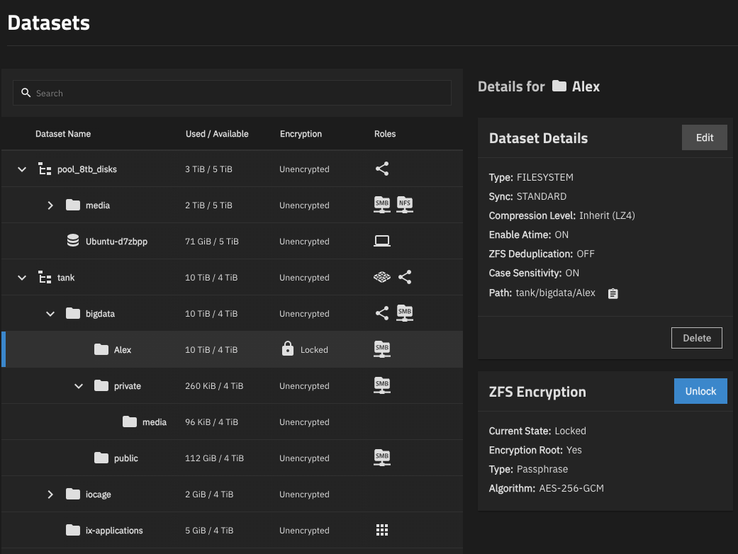

Meaning: @intercom please describe your setup in detail.
zpool status shows that "tank" has corruption in metadata. This cannot be repaired; you have to destroy the pool and restore. But it would be useful to understand what could have caused the damage.

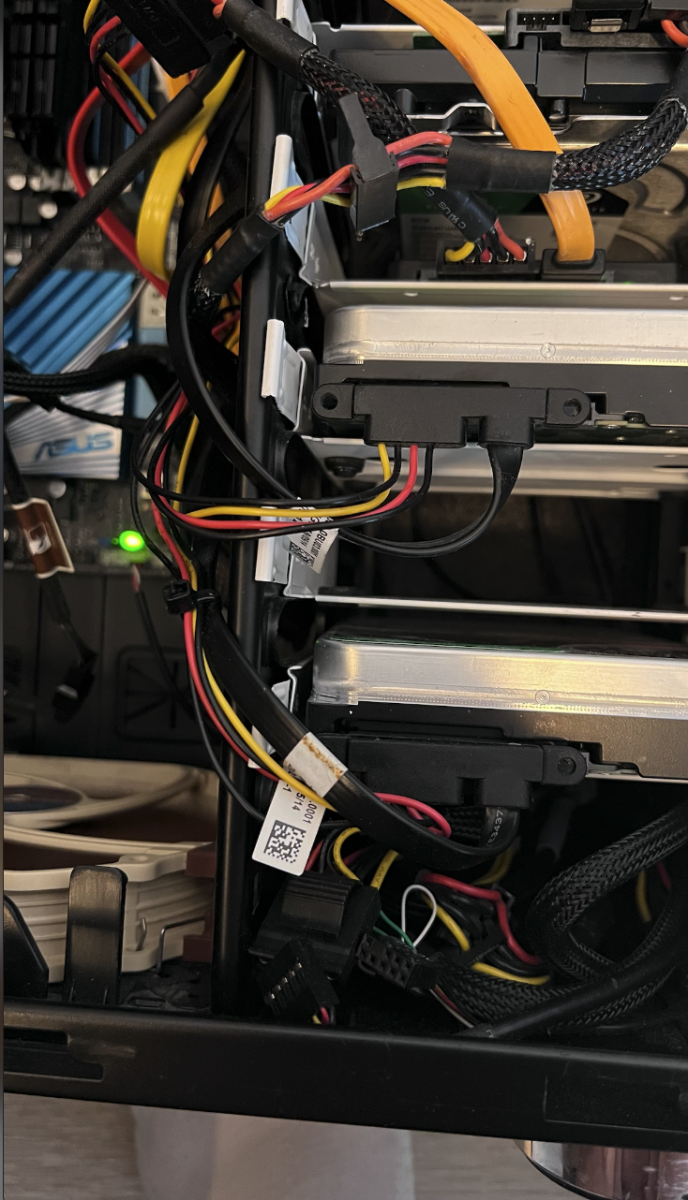

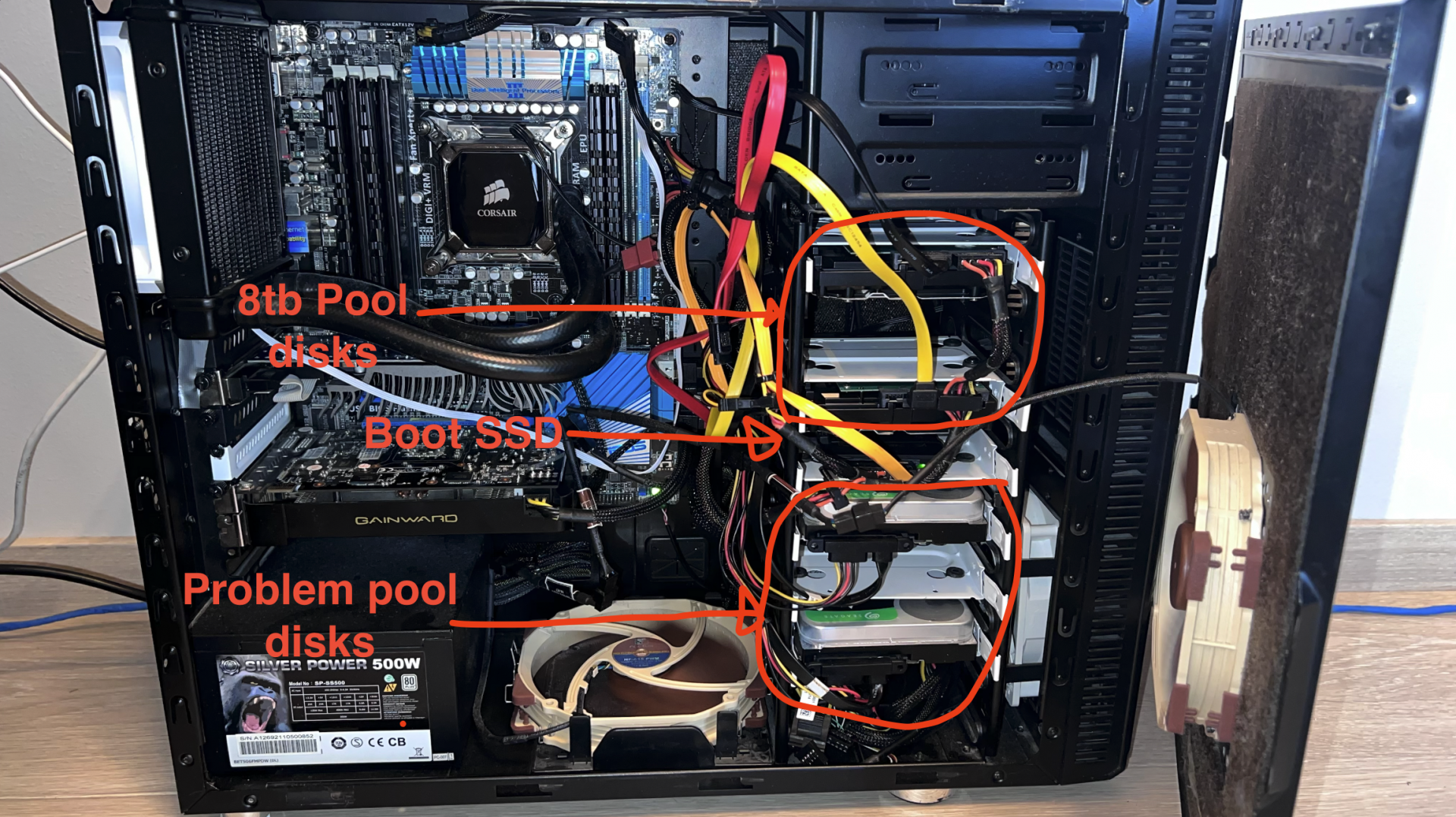

I thought my screenshots would provide some info, it is a Asus P9X79 motherboard, 32 GB ram, 2x 16TB disks (which is the problem pool) and 2x 8TB disks that works fine.
What does it involve to "destroy the pool and restore"? Do I have to delete all 16 TB of data, then create a new pool?
If so, I cant understand why on earth people use TrueNAS - I have never had this happen to me on a mac or windows computer in my life.

I mean, isn't that the point of running a mirrored setup, so that if there is corruption then I would have a backup?
I ran 'smartctl -a' on the two drives in question:
None of the screenshots tell us whether it is bare metal or virtualised, which motherboard, and CPU, how much RAM, ECC or not, which model(s) of drives, how and to what controller they are attached… All of that, and possibly some more, is relevant.
Yes. That's why one must always have backups (a redundant array, in itself, if not a backup). If you don't have a backup, get some drives, move the data out and check that the data is still valid. (Yes, manually inspecting files one by one…)
Yes. But redundancy is not a backup. Redundancy protects against drive failure or occasional errors; not against an overheating controller or errors in non-ECC RAM being written back to disk.

Ok I see, it is not a VM - its a "normal" computer. CPU is Intel(R) Core(TM) i7-3930K CPU @ 3.20GHz.
32GB RAM. ECC I dont know what even is, I apologize.
I have backup in the cloud of almost the entire drive, but could I just replace the files in question and then "reset" the status of the pool or something? If only the file names were a bit more descriptive than:
        tank/bigdata/Alex:<0x894b>
        tank/bigdata/Alex:<0x824c>
        tank/bigdata/Alex:<0x8166>
        tank/bigdata/Alex:<0x888b>
        tank/bigdata/Alex:<0x89a8>
        tank/bigdata/Alex:<0x84cf>
        tank/bigdata/Alex:<0x81e1>
Is it possible to get a better description of the filenames than this?

No, because these are not data "files" these are ZFS metadata, i.e. ZFS internal structures. Your data is potentially still there and still valid—but you'd have to check. Unfortunately, this metadata cannot be restored or corrected, and from there it's only going to get worse until data loss eventually occurs because files, or even entire directories, cannot be properly identified.

Would it mean that I "only" need to empty out the "Alex" partition and then delete that and make a new one?

Deleting the Alex dataset is certainly worth a try.
Delete, scrub, examine result and then restore Alex

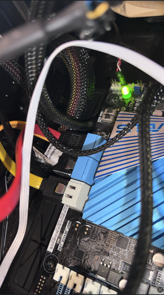

I took som pictures to show a little better.
There are 2 grey connectors, these are connected to the two 8TB disks. Then there are 4 more blue ones, I dont think there is a color difference between them.
The ones going to the "problem pool" disks are divided between SATA3 and SATA 2 (the blue ones in the middle and the blue ones at the far end from the grey ones.
The boot drive is connected to the other one of the two connectors in the middle.
Problem pool disks has these connectors on them that extends the data and power connectors, might be possible source of problem?

Can you please be specific about the model of motherboard you have as I seem to have got the wrong one in my google-fu
SATA power cables are ideally not extended. Molex carries a lot more power - so yes - its possible.
Whats the GPU?
Lastly how old is that PSU? I am guessing - very

Remove as much as you can. IF - and its definately an IF the PSU is going weak - then removing a GPU cannot harm. Mind you they are not terriblky greedy GPU's
Replace the BIOS battery if you even think that might be an issue - do that next.
I am more worried about the SATA power extensions than the SATA cables at this point

Actually looking at those extension cables - are they just power and SATA into one module OR are you adding additional ports onto the SATA cable from the PSU (and plugging in disks. The later is the situation to avoid, the former shouldn't be an issue (providing quality is good)
With a very old PSU - you might be limited in the number of actual SATA ports from the PSU so have added to them. Molex carries a lot more power
Very possible. it took like 3 hours and one reboot for my machine to start giving me CRC errors after I used a SATA Y-Splitter. That worked fine previously but I'm pretty sure it was connected to molex before. If you absolutely have to use that extender, at least use molex.

I have replaced the SATA cables for both disks and chucked those connectors shown in my last post in the trash. Now I am going to start the process of backing up 10TB so I can delete the entire pool and remake it.
