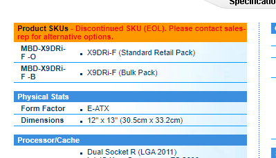

Hey anyone know if the supermicro X9DRi-F has standard mounting holes... ie would fit in a fractal xl r2 which says it fits e-atx? Without drilling
Having a few problems.. accitentally bought an EE-ATX that doesnt work without drilling
Redcoat
Feb 18, 2014
2,922
https://www.supermicro.com/products/motherboard/Xeon/C600/X9DRi-F.cfm says
