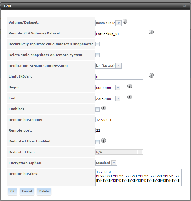

My experience with the API and python is a few hours, there is a good chance I may be at fault.
Enabling and disabling a replication task through the web interface doesn't clear the hostname and SSH key but using the API update does.
http://api.freenas.org/resources/storage.html#id9
Build: FreeNAS-9.3-STABLE-201511040813
Hardware: ASRock C226WS | Intel Xeon E3-1275 v3 | KINGSTON 32GB ECC DDR3 RAM | SAS9211-8i | 2x WD Red 2TB, 2x Hitachi Deskstar 5K3000 2TB | Raidz2
I have one dummy replication task configured and can get that with the python script below.

I then try to update the task through the API as shown in the documentation.
CODE:
print requests.put('http://nas/api/v1.0/storage/replication/1/',
    auth=('root', 'password'),
    data=json.dumps({"repl_enabled":"true"}),
    headers={'Content-Type': 'application/json'}
).text
RESULT:
{"repl_remote_cipher": ["This field is required."]}
For some reason "repl_remote_cipher" is required. :confused: Cipher was already set. Ok, now again with "repl_remote_cipher".

Task is now enabled ("repl_enabled": true) as shown in the result above and in the web interface but the hostname and key are gone.
Is this a bug or am I executing this wrong?
