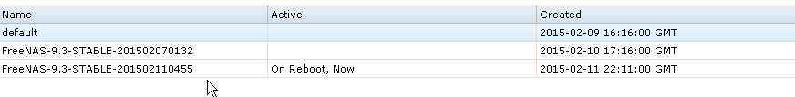

Anderath
Feb 10, 2015
Same issue here. I'm using the "default" boot volume. It seems as though the current environment replaces the default boot volume when there's a new update available that is installed. Am I correct in that assumption?
Here is log file:

So I tried rolling back to "default" and then trying to redo all updates.
I still get the alert saying the updates failed notice but I can login to the UI and everything appears to run as normal.
Here's my available boot options:
Can anyone make a recommendation? Should I just backup config and reflash my USB?
