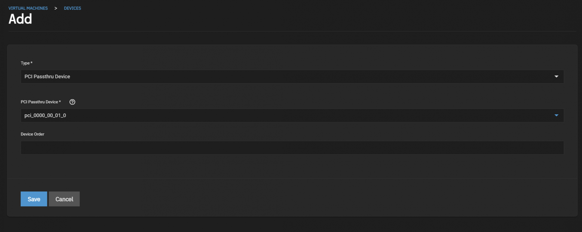

Yes, its more or less the same process on SCALE. You add a new device and select "PCI Passthrough" type:

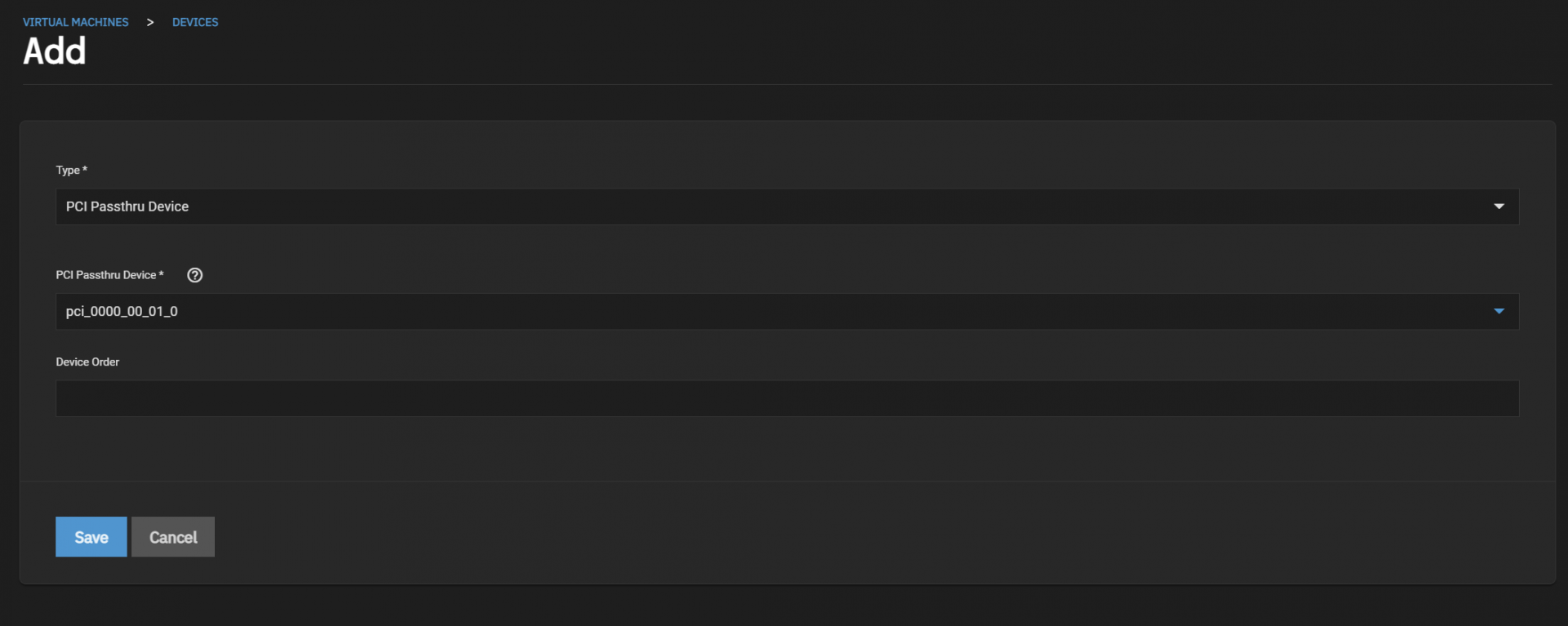

1. at linux shell use lspci command
2. search the pci device
3. if device is 00:03.0 the pci passthru device is pci_0000_00_03_0
picture come from
kingwilliam
Dec 7, 2021
5
one more things
4. but, at ADD pci passthru device don't click too fast, you need give little time the system to search device, if not, the list is empty, pls try after 15 second, you can choice pci device form the list
