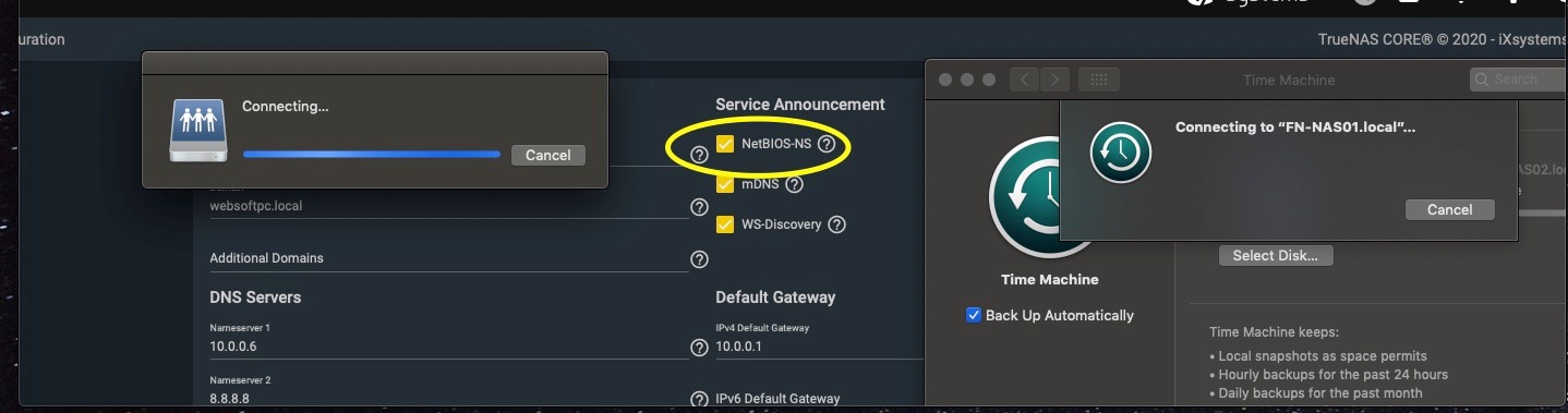

I updated to beta 2 this am. I am still was not able to see my time machine shares until I checked the box netbios-ns under network global configuration. I see the share but it will not connect. Please see attached.

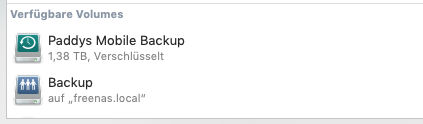

I don't have netbios-ns active and time machine works for my son and my wife. Although they connect to smb://freenas.local/Backup, apparently.
