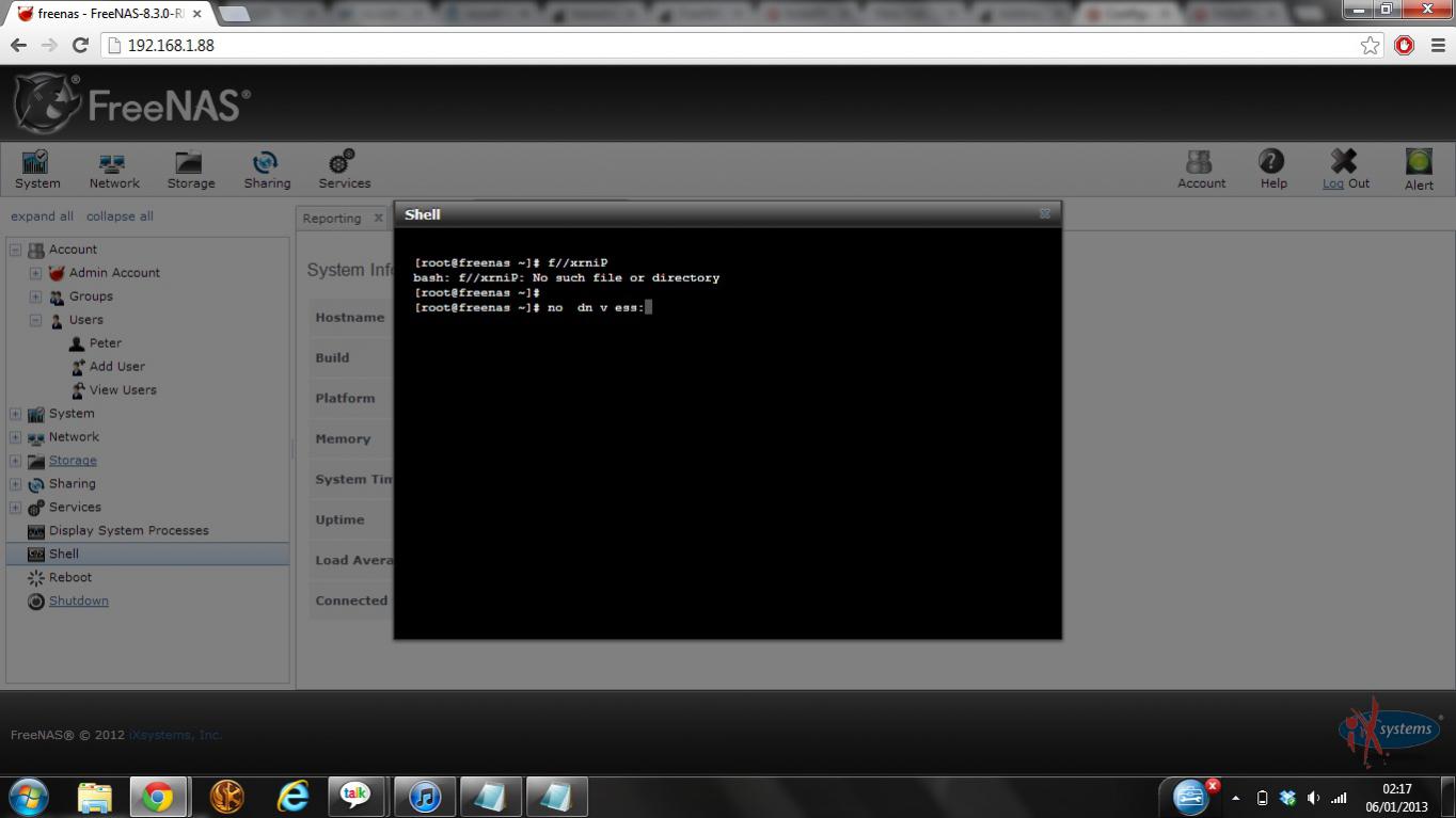

I am following this guide and I am getting to the bit where i am inputting the stuff into the config.yml (i think) and its acting very weird. to the point where when i hit enter after typing vi /mnt/Volume1/Software/.flexget/config.yml It doesnt seem to want to let me type it properly if flashes between the 2 photos i have attached randomly. Although after i have tired this it seems to do it every time i type anything into shell.
e.g
say i type vi /mnt/Volume1/Software/.flexget/config.yml into console the random flickering in shell makes me type vi /mnt/Volme/Sofwar/.Flxgt/confg/.yml
I know the problem isnt strictly related to flexget but the problem occoured after i first typed in vi /mnt/Volume1/Software/.flexget/config.yml so do you have any ideas?
also im guessing the console area i am inputting the config info into is the correct place. (i was hoping i could copy and past one i prepared in advanced in a txt doc thats all)

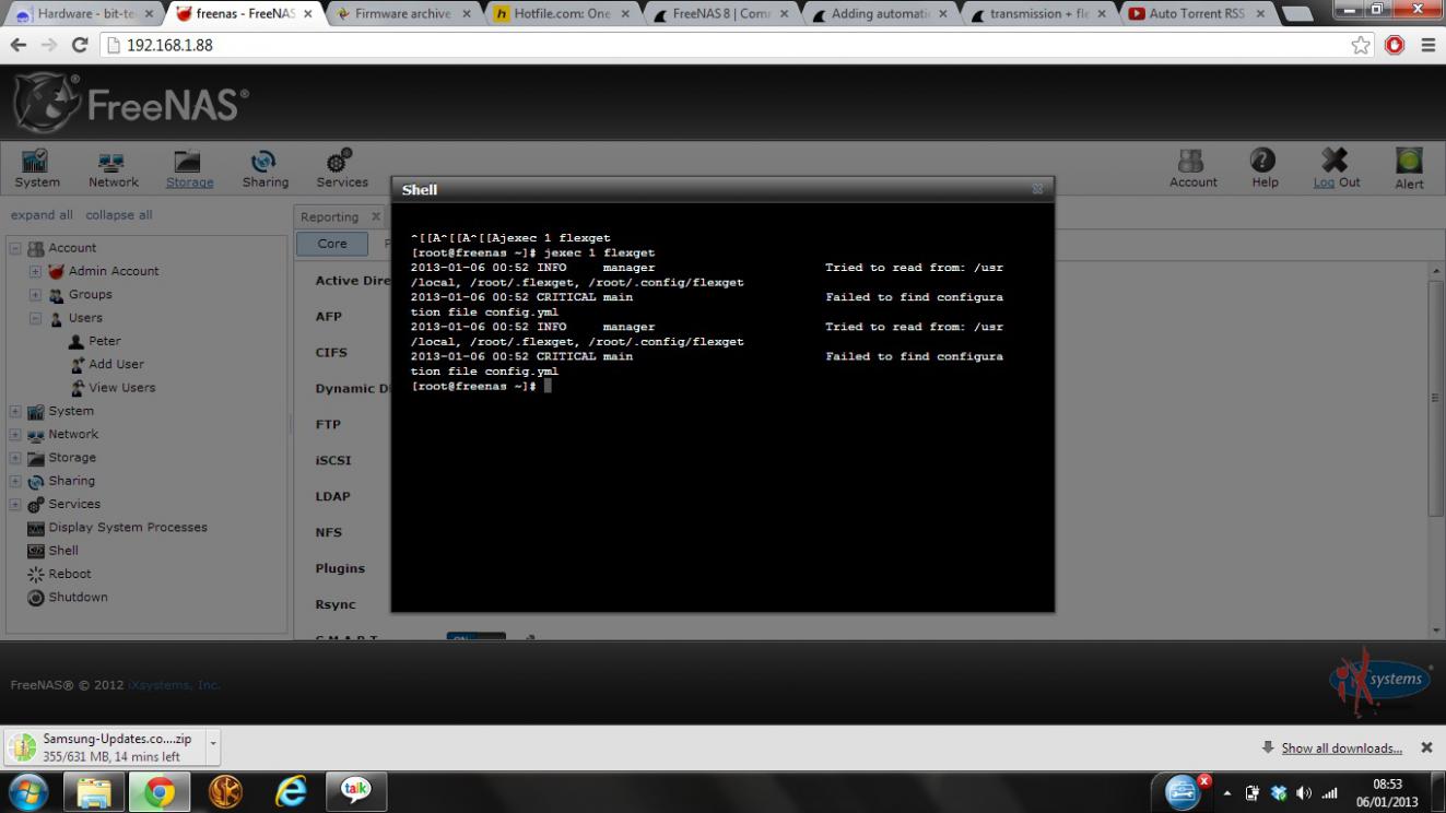

I think I have managed to sort the config file issue now.
for one the shell isn't having the problem anymore (yay) and after playing with permissions i found the .flexget file in the file path /mnt/Volume1/Software/.flexget and i manually created a txt file that i put my config in and renamed it config.yml. ( can i just check this should work shouldnt it?)
the only issue I have now is i run a 'jexec 1 flexget' command and I get the message that is in my picture which i am guessing means flexget is looking in the wrong place for the config file. As i am really new to all this. is there a command i can type to make it look to where I have put the config?
cheers
