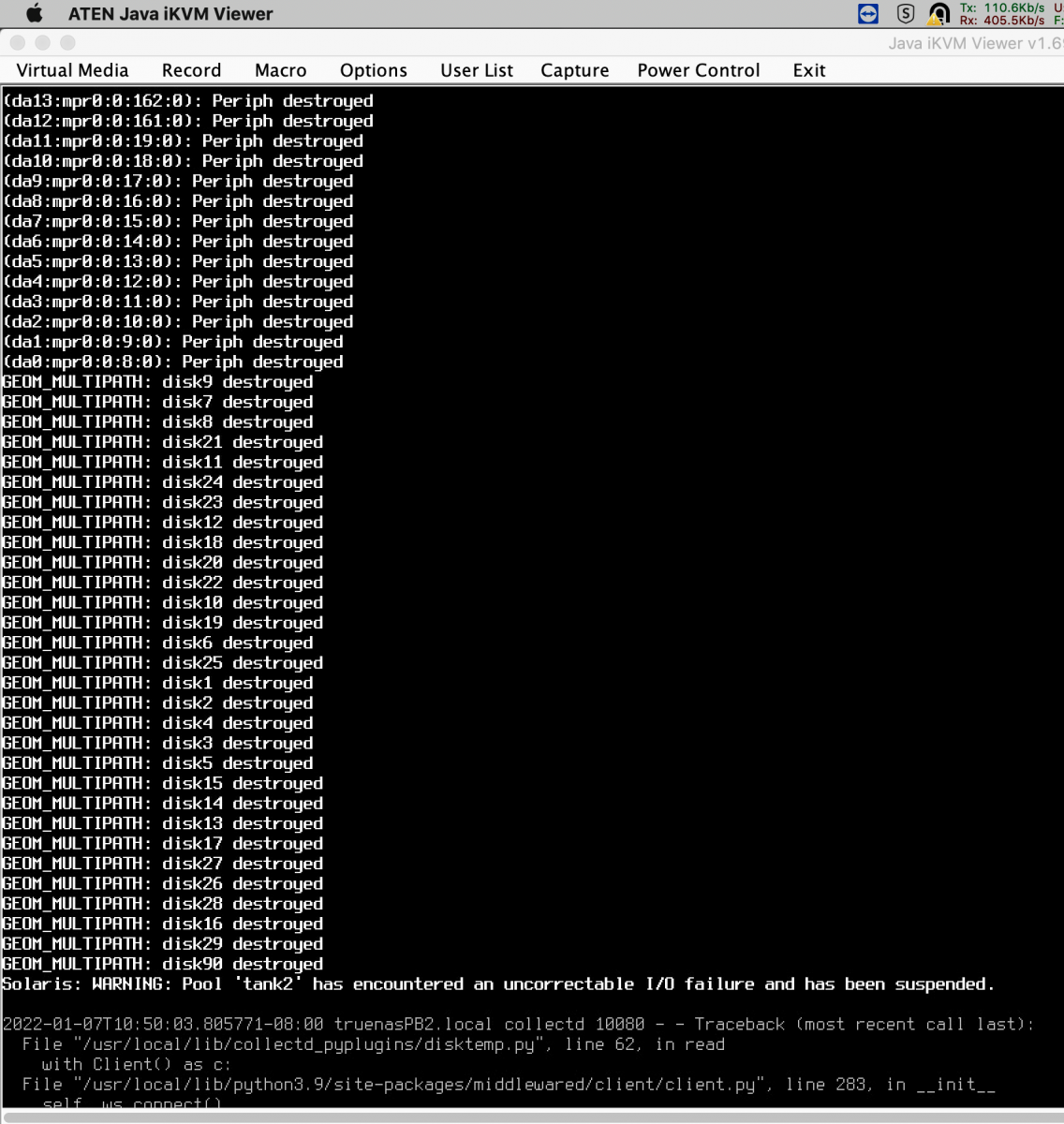

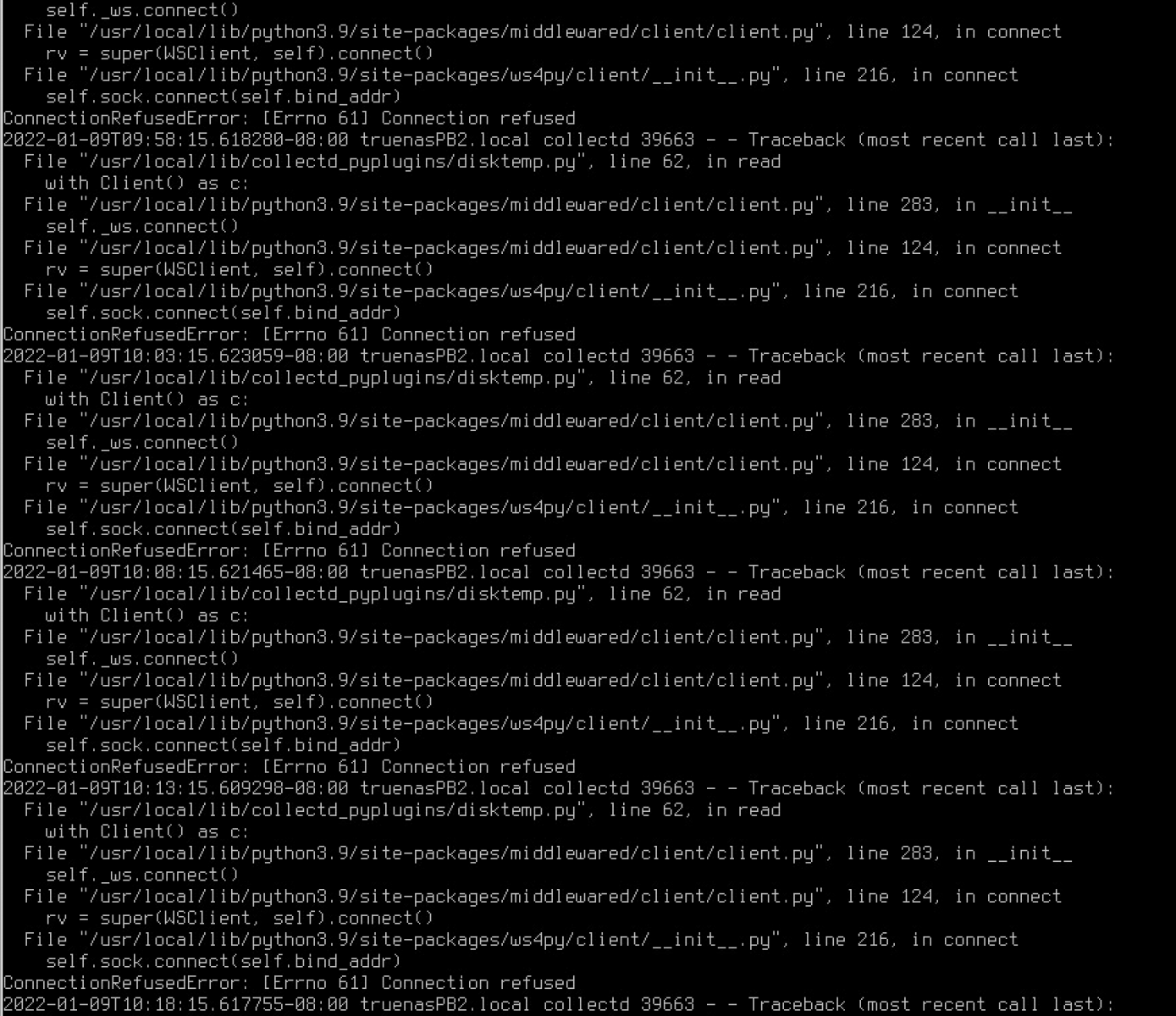

However a week later, the server started to randomly crash. We are not sure why, there are no errors on the JBOD controller. The freenas web gui would just stop working, and the middleware service crashed.
Sometimes we get an error message saying 30 drives popped offline, other times we get the python code error messages when the server crashes.

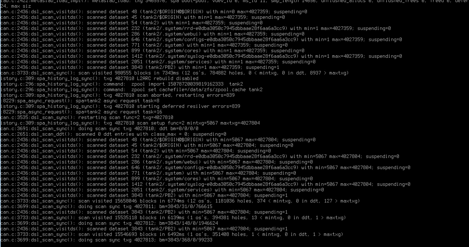

In either case I have to power cycle both the JBOD and the head unit. Upon reboot, the TrueNAS server will see the pool and do the import and then run some txg reallocations. After about 30 mins the server will boot and the pool will return.

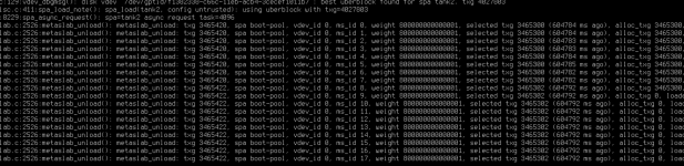

However when I run a scrub at about 5% the server crashes again. Giving the python error codes in the attached picture.
We are going to try swapping the JBOD chassis tomorrow, but I'm curious to know if anyone has any other ideas on why our server keeps crashing and giving the python error codes about middleware.

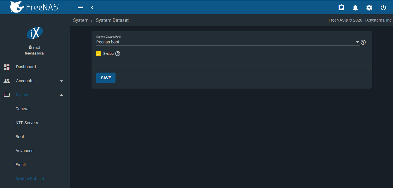

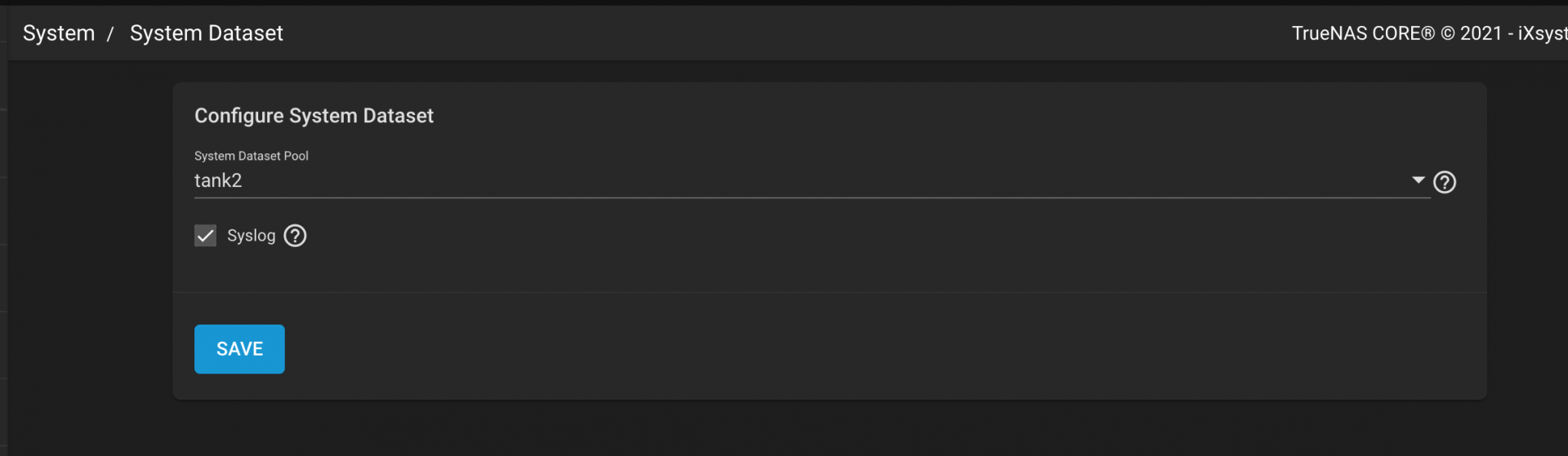

Where is your 'system set' located? Can it be on the (once) faulty pool? Have you tried moving it to a different one?
Do you mean my OS? I have two pools the boot pool and then the tank(data). I'm not familiar with the system set.

The Python errors look to me like the middleware isn't running, that's just a guess. I don't see what's causing the middleware to crash.
Given that you have a setup a lot closer to what iXsystems sells than many of the users around here have, the developers might take an extra interest in a problem report from you, and may be able to provide some additional guidance. If there's a bug or issue causing the middleware to crash on large systems after a disk replacement, that's potentially noteworthy.

The System Dataset is what Jessep pointed out in the screen shot, if it resides on faulty pool, I suggest moving it to the boot, and see if it helps.

The system dataset is on the Tank. Should it be on the Boot drive?

Suggest you try moving it to a different pool (Boot drive is an option) and watch how it behaves.
Temporarily to verify if it fixes the issue this is something you could try. I would not recommend this as a permanent option unless your boot pool is redundant. Otherwise a boot disk crash would kill any possibility to recover your installation afterwards.
Installation can be recovered by backing up the system configuration. Everyone should keep their system's configuration backups up to date as well as the data backups, regardless of where the system data set resides.
