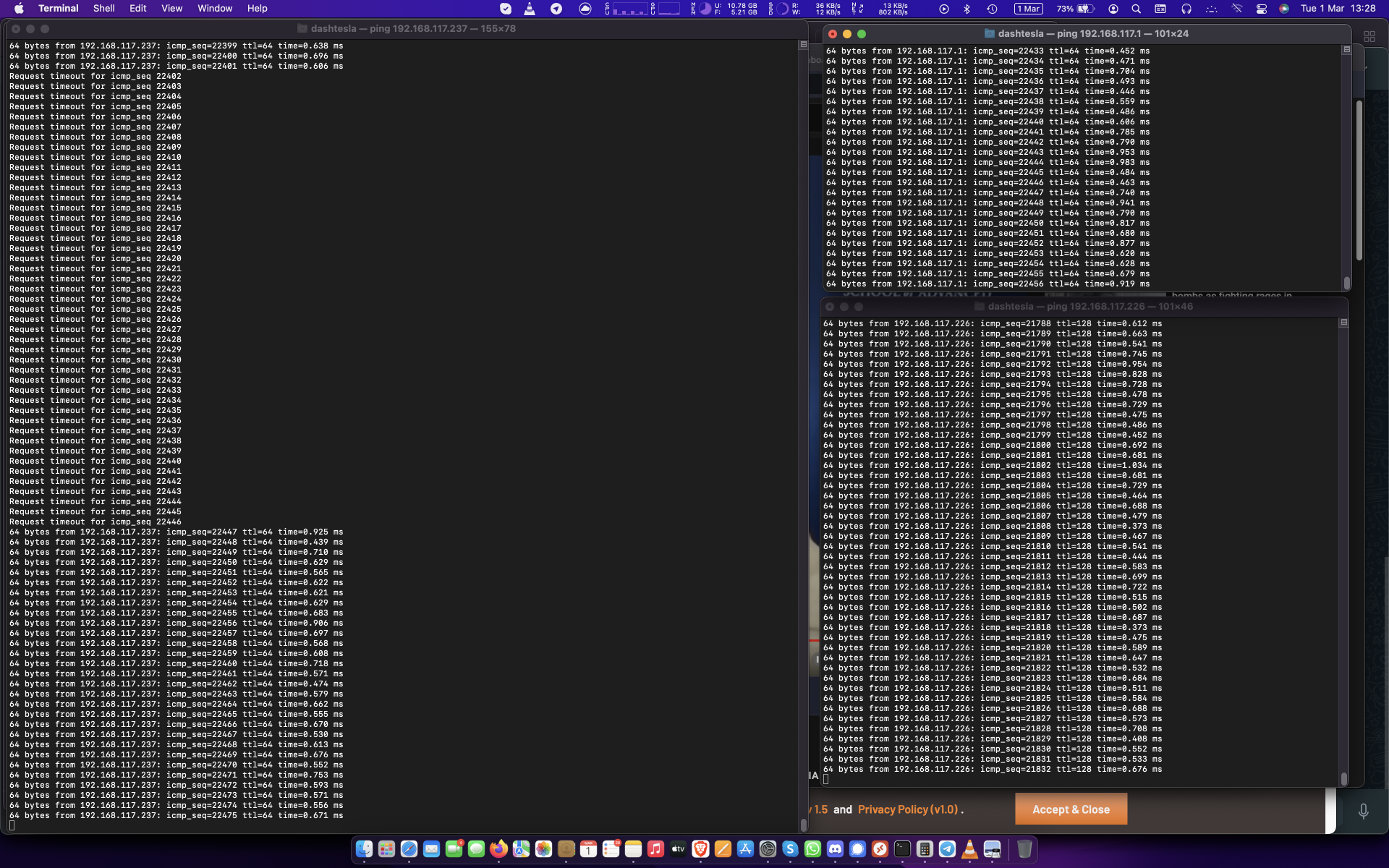

The VM works perfectly I have the drives on passthrough so the vm does get direct access to the hard drives and ssd for cache everything is fine except for the network took me a while to figure out but whenever i was watching videos i would get random pauses for a few seconds and even macos would eject the share mapping so the video would stop playing (vlc) then i would have to go to connect to server remap and find the folder/file double click and then queue from where it was playing before if i wasn't fast enough to check where it was i would spend about 2-3min to resume playing the video sometimes having to close everything and restart the mac because it just wouldn't remap the smb again (probably some mac related issues with dropouts).
226 is the hypervisor, 1 is the gateway 237 is the truenas vm as you can see from the picture the problem is specifically within the truenas vm hypervisor works fine i also tried an intel 10G SFP+ card i'm currently using the onboard 1G intel 219 and the problem was exactly the same so not a hardware problem and the way i see might be related to freebsd drivers/compatibility with the hyper-v network adaptor but i could be wrong so that's the whole point of this thread, trying to figure out if there's anything i can do/change to make the network run stable.

What bothers me is what I used to have a different system back when it was FreeNAS and past a certain version it stopped working as well as it did, back then i didn't do anything special besides what i've done here this is why I believe it's probably a freebsd driver issue and not a truenas/freenas specific problem but i would have to setup a freebsd vm and setup shares etc run long-term to prove the theory.
Right now my options are to run truenas in this manner or use microsoft storage spaces/raid5 both options are terrible, proxmox also can't do what i need at hypervisor because i need direct gpu access in windows and LTFS with my tape drive to manage data backups with windows explorer.
Right now the only problem is the network I wish hyper-v had more options to passthrough network/usb/pcie devices, I feel like the best option is to wait for truenas scale to be released properly and switch when the time comes hopefully i can take my encrypted ZFS pool to it.
