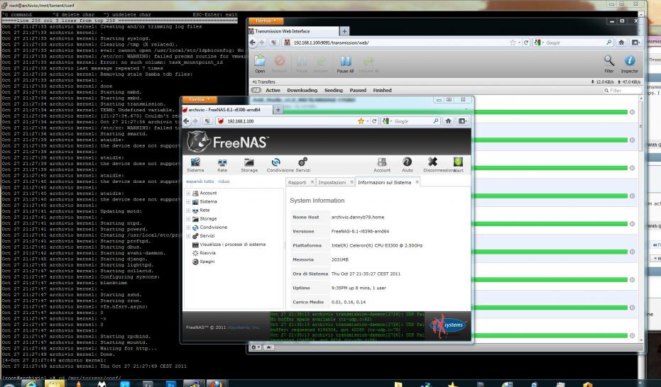

OOPs! I have some issue at reboot. Followed masterpc instruction I delayed transmission daemon start, but I always get a "undefined variable" message and daemon stops. I starts just typing transmission-daemon -g /settings-path and all works fine.
there is some more detailed logs, so I can find what variable is undefined?

I have a stupid issue on autostart, probably a mis-typing error. once manually started the daemon it works fine
You probably either mis-typed or added an extra character when you edited the startup script. I'd go back and double check the edits made. Good luck.
dannyb78
Aug 30, 2011
70
thanks jerry, I already solved. It was a permission related issue on download and config folders ;)
