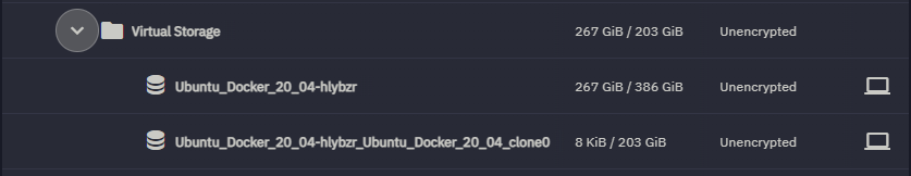

Testing of clone creates a clone of the zvol in the same dataset
Testing of start does do a start - works just fine
On the subject of the clone:
  1. Note the size of the clone in comparison to the original. This would imply to me that its a snapshot clone (is that the right phrase) rather than a full clone
  2. Its a very quick operation - a few seconds

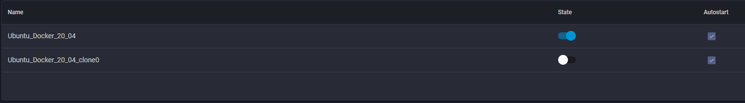

  3. Under virtualisation (GUI) I get

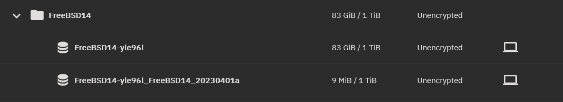

Oeps!! I discovered what I did wrong !! :eek:
I was using a snapshot of the data set, where I should have made a snapshot of the zvol used by the VM !

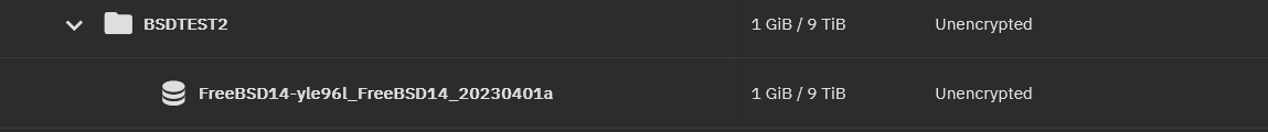

I think its OK 1GiB is not much, but it is a minimal FreeBSD-install, so it could be correct (I did not yet test it). A bit strange the original ZVOL was much bigger.

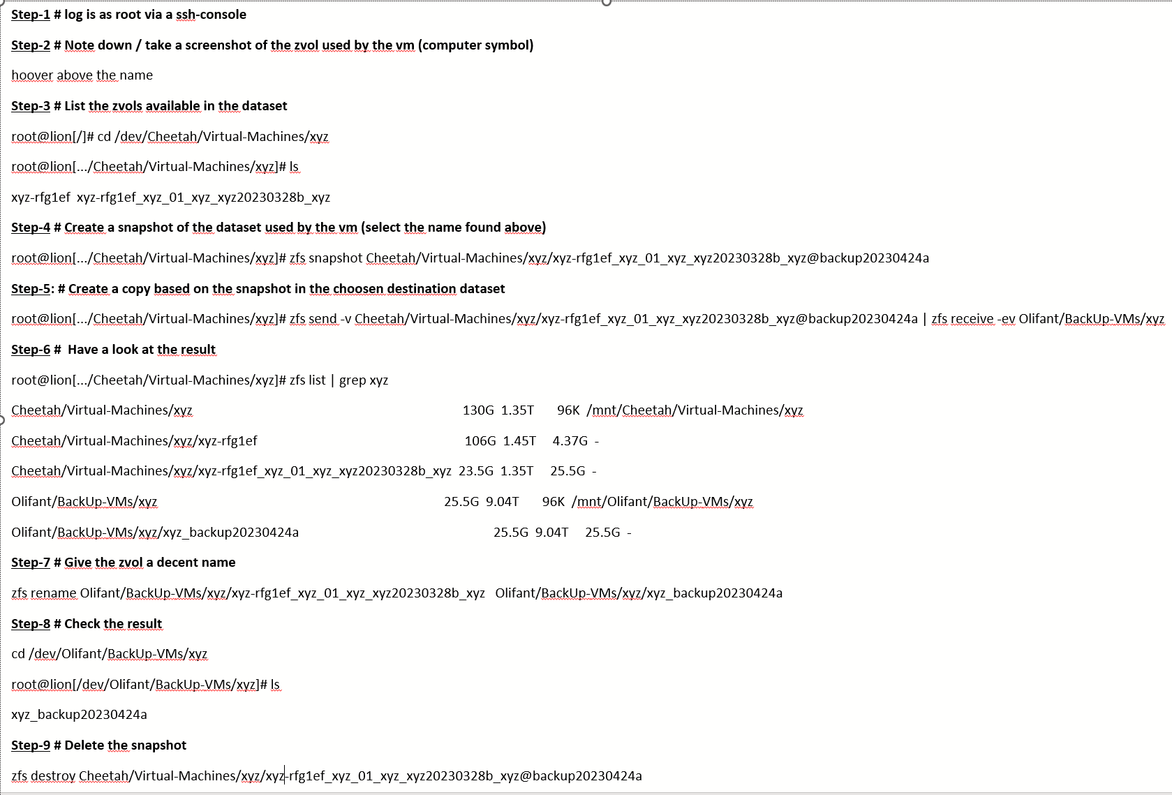

I hope that the result above is correct. Assuming that for the moment the procedure I followed is described below.
Very very annoying the extremely long names ...... with the relevant part at the right (=wrong :wink:) side ....
