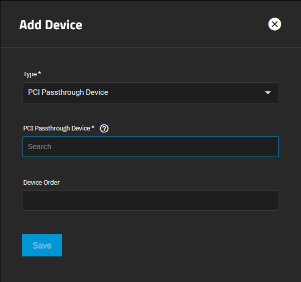

My USB controller does not show up in the PCI Passtrough menu
How can I pass the entire controller to the VM?

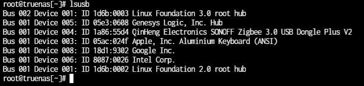

lsusb does show the Coral (18d1:9302), but it's still not in the usb dropdown.
Specify custom with "0x18d1 / 0x9302" does not work

I solved it. How?
`lspci | grep USB` > found my USB controller, pass it through to the VM (PCIe passthrough, in my case it was
00:14.0 USB controller: Intel Corporation Device 43ed (rev 11))
Now all my usb devices are listed in the VM.

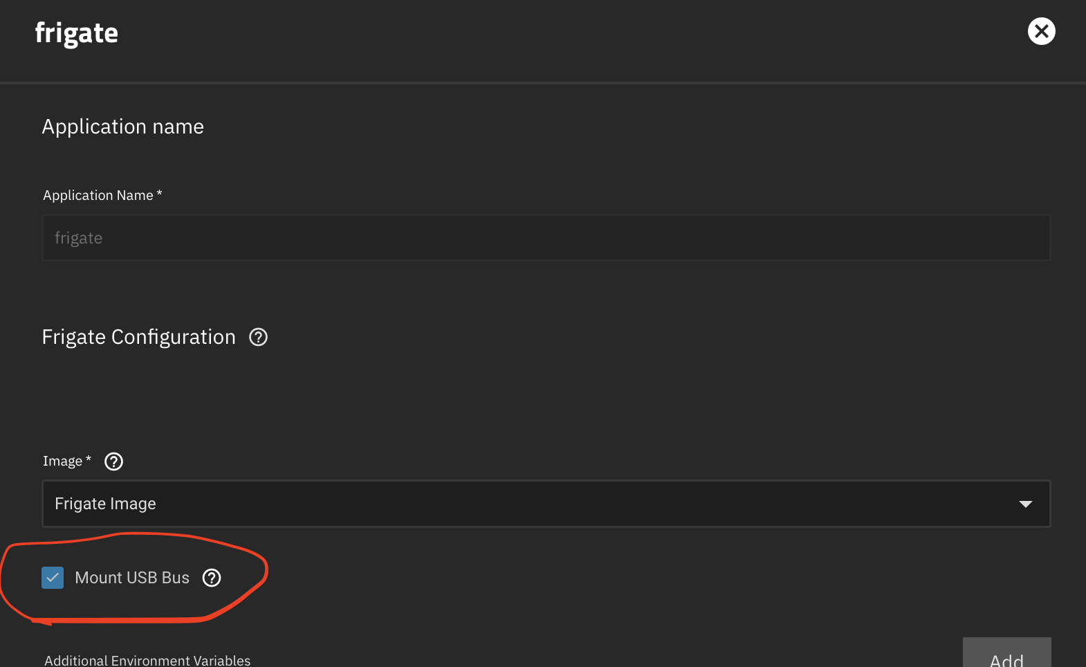

My coral just arrived. I was prepared for days of debugging, alas it is much easier than that! Frigate (0.12.1_1.1.4) from the TrueNAS catalog has a checkbox under "Mount USB Bus", from thereon it worked automatically, no drivers loaded.
Screenshot shows in detail where this checkbox is located.
