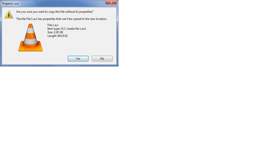

Hi all,
I have a very strange issue that I have been working on for weeks to the point that its driving me crazy , after scouring the internet and searching through numerous forums including this one I have yet to find someone who had experienced the same issue.
Problem: The issue first exhibited itself when I was attempting to mirror my local photos and video folder (from a windows 7 machine) to a newly created share (a mapped drive using matched credentials on both freenas and my local machine) using a program called beyond compare, certain files had failed to copy over. Of the 100's of avi files only a handful had failed .

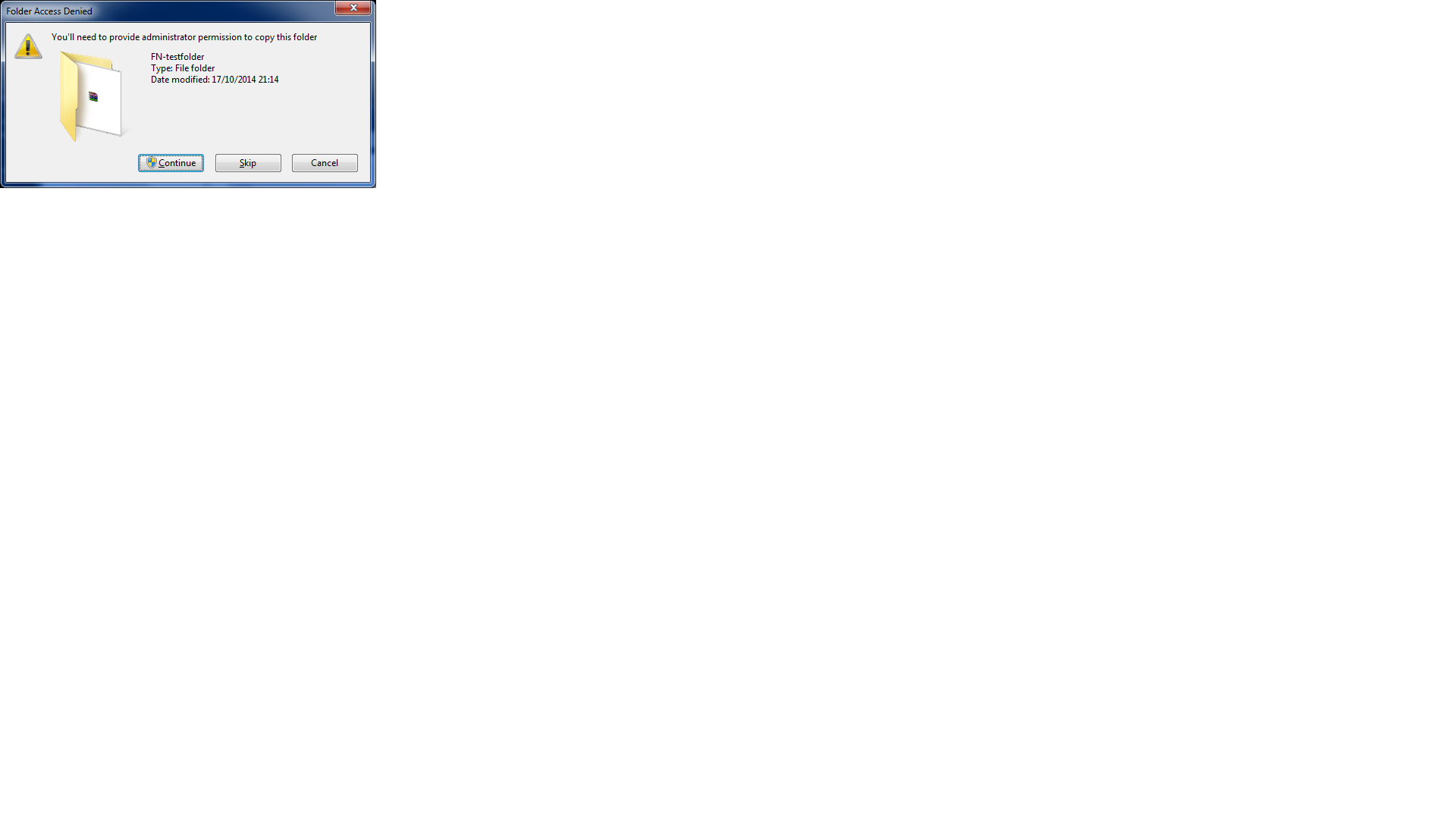

only when I manually dragged and dropped the file to the share did I then notice odd behaviour, the file would copy over and I would see the file on the remote folder however at the end of the copy it would delete and copy over again and then at the end of that copy would say that "you'll need to provide administrator permission top copy this folder", odd.
initial thoughts that it looked like a permissions issue, however after comparing to other similar files (and larger) all attributes were the same, i had no problems with the other 900Gb of data that copied over fine.
To see if this was freenas related I tried copying to other PCs around the house, another windows 7 pc , which copied fine , I then tried to copy this to another samba share running on Ubuntu when it gave me an error saying "Are you sure you want to copy this file without its properties?, the file has properties that cant be copied to the new location". I clicked yes and then it copied and also played fine. I then copied the file back from my ubuntu share to my main PC and then copied the file to the freenas share , guess what ? it copied over without any issues!!
searching around on embedded proprieties led me down a line of enquiry looking at issues with files with ADS (alternative data streams) , using a tool called "LADS" I compared the file that I copied to Ubuntu (now renamed file2) and the the file with the issue (File1), LADS showed that the file did have an an alternative data stream.
So there is something strange the way the latest iteration of samba handles these kind of files especially ones that are specific to an NTFS file system :(
I hope someone can help me with this really strange issue before I go insane...Please help !!

To clarify a bit more - samba supports NTFS alternate data streams, but the length of those is limited to 64K (cumulative over all streams for a specific file, I think). I hit a couple instances of too-large alt streams when I first set up my NAS and tried using the built-in Win 7 backup. Those were old files produced by, IIRC, a movie-maker app. The fix was to get rid of the streams on just those couple files. I did that using the SysInternals streams.exe tool, from www.sysinternals.com. Normally, it should be fine to get rid of the alternate streams, since they shouldn't be relied upon. Because they're supported by NTFS but not FAT32 or ExFAT, you'll easily lose them when copying to a default-formatted USB stick. So most apps that use them don't rely on them for correctness, just for optimization of some kind.
When you clicked yes to the error dialog, you were telling the OS to go ahead and strip off the alternate data streams. So when you copied it back to your main PC and overwrote the original, you got a copy without those streams, and the file could be copied to FreeNAS without a problem.
