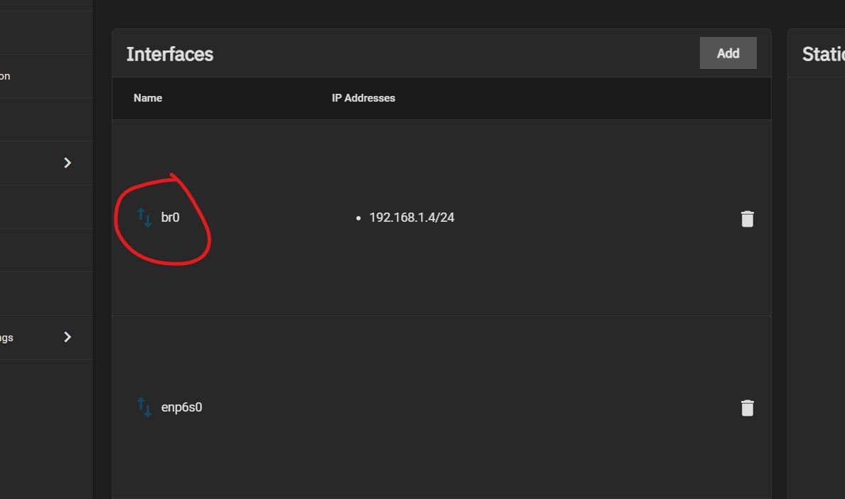

Just to confirm about the same bridge we are talking. is is one as on my screenshot?

Bridge has to have as member your physical network card. That bridge has to be assigned to the VM. Not 100% sure but after you create and save bridge you might need to reboot truenas.
Bridge isn't necessary for VM. My Ubuntu was running without bridge too... Display - you mean the VNC display in truenas VM menus? Also does your bios is set for virtualisation? Attach some screenshots, it's hard to understand like that what's going on
